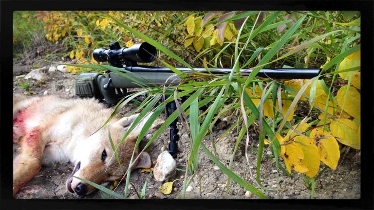

I recently picked up a 1st generation weatherby vanguard (howa)in .223, with a houge overmold stock on a trade and I am very impressed with the fit and finish.The houge stock free floats the barrel which helps with accuracy and is very grippy in wet weather and makes little noise pushing bush. The adjustable trigger is creep free and very crisp. The action is as smooth as my Sako A7s.I have my new favorite coyote rig. Pic from last weekend.

Glad you liked it, I was very surprised with the Vanguards. Action was smooth, Fit and Finish was nice, Very accurate. The Axiom stock on it was paperweight. The only issue I had was how its not common and thus was hard to find that Houge stock. Trigger was best I fired out of the box.
