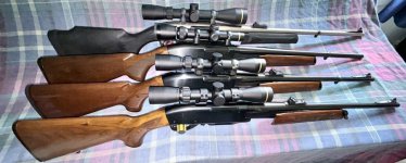

I’ve owned Remington 740’s and a 750. The 750 was junk in my opinion, it went back to Remington, I got my money back. You have to look out for receiver wear on 740’s and 742’s, due to the locking lugs of the bolt and the soft receivers. 7400’s and 750’s did not have that problem. In my opinion, if you want a Remington, look for a 7400.
I prefer my Winchester. It is easier to do a full, and I mean full, disassembly on. And it doesn’t have the receiver issues of the earlier Remingtons. The 100 did however have a firing pin recall. The one I bought did not have the recall completed. I contacted Olin, they mailed me a new one, I put it in, good to go.
As far as accuracy goes, with handloads I got 1.5” groups with my Remington and I get 1.5” groups with my Winchester. So the samples that I’ve had are equal.
All that to say, why not just hit well with the first shot? I’ll tell you that with the recoil and stock design of these rifles, it’s not like you can just keep firing dead on at your target. Neither of these rifles have stock designs that lend themselves to mounting a scope and having good eye to scope alignment (except for a 7400 with a Monte Carlo stock). I’d say take your time and place your first shot well with your bolt action.
I’ve owned / still own these semi’s, but always find myself grabbing a bolt when it’s time to hunt.
