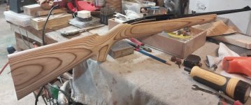

Well, I finally got home and started playing with the stock. My gun is pre 64, so the stock has gaps at the lug, I'm just going to fill them in with black epoxy and call it good. These stocks are inherently weak due to the one giant inlet hole, so I'm thinking of bedding the back lug, and pillar bedding the front screw. Also thinking about slathering some epoxy along the sides to strengthen everything. Otherwise, the stock fit in perfectly and tight, so pretty happy about that. I chucked in a couple pictures, and one of the old stock. Hope this helps you with making a decision!I checked into Numrich myself and it looks like they only have the post-64 stocks - drats!

I was thinking of scabbing the old stock together with some diamond shaped inlay of fibreglass to hold and strengthen the sides, but it would probably look like crap, and cost a whole lotta time. Good luck with your stock, hope it turns out well!Thanks! Exact same break on mine, except only one-sided. There’s a very seasoned gunsmith not too far off that thinks he can stabilize the crack. If he can do that to one side I’m going to ask for some preventative measures to be installed on the other side. What a beauty stock you’ve got now, worth the money I’d say.
