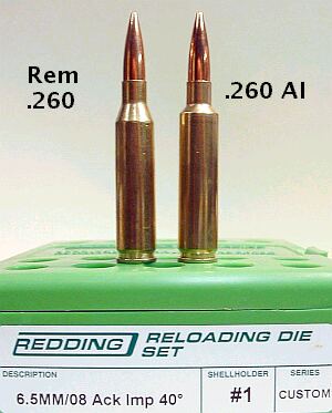

.260
So off I go reading for hours about .260. I think this caliber with a fast twist for heavier bullets and a 26"ish barrel is the exact thing I'm looking for. Great at the range pushing it as far as I'm capable (which is what it will do most), and still capable of ethically hunting deer at respectable distance (If I ever decide to go out with my uncles).
Now I'm a total newb at reloading but I know I will be the type to enjoy it and I plan on kitting up for it so my question is, is the Ackley worth it for the difference and is it difficult / expensive to do all the resizing etc. they talk about?

The 260AI or my 6.5 Mystic (a bit bigger but very similar) does require forming brass and some prep but once that is done, long case life and consistent performance. The brass prep is the same regardless of chambering so it is the same work load for me.
Trimming is a very rare occurance and I have gone through more barrels then batches of brass. Annealing is key to this longevity.
The only issue is the time it takes to fireform - I use a light load of pistol powder and cornmeal - and there is no real wear on the barrel. Cost is pennies to do.
This is the only chamberings I have shot for F class and one of the several for my LR endeavors and it has done very well for me.
The velocities you listed are easily reached with moderate pressure and the part I like the most, is the ease of tuning out vertical.
I have shot both 139gr Scenar and 140gr Bergers. Both perform wonderfully over H4831SC, CCI BR2 or Wolf primer, in Winchester 308W brass.
I do throat the standard chamber longer so I can get the best seating for the boattail in the case. Overall length is close to 3". I single feed.
Dies are no problem as you can use 260rem dies for neck sizing and seating and Redding now offers a body die specific to this chambering. I used the Redding 7-08AI body die and it has worked superbly. Still have 1 for sale.
