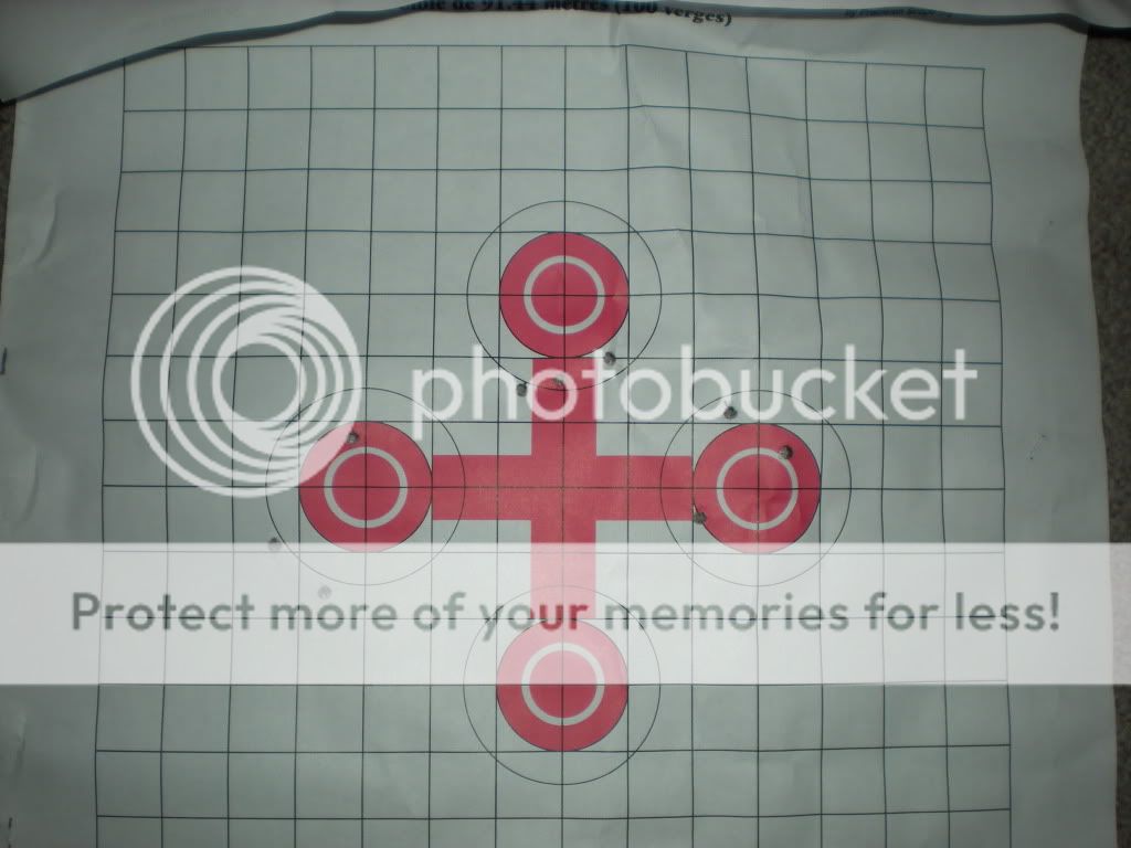

Any way it turns out it was the scope, get to the range today and get some nice grouping right off the bat at 200yds with Amarican eagle ammo, 1 group of 3 and about 1.25moa then 2 groups of 3 at sub 1moa. the group left was shot first, then right, then top.
adjusted my windage settings and every thing goes out the pooper again... then i notice then the windage turret has a bout 3/32" wobble in it when its spun... so long story short... the fact it happened when i changed ammo was more or less a fluke, the slightly loose action screw didnt help any and the rifles getting a new scope...

interesting link, i understand that it could be "cheating" to measure it how i have with having each group separate from each other.. i just did it this way so i could keep track of all my shots easier.. that being said, if i were to cut out each circle and place them over top of each other the 2 furthest shots from each other (left group low and right group high) would still be just over 1.5MOA at 200yds with factory ammo, which i think is pretty decent for factory ammo. any who thanks every one for the input and suggestions, next time out i will make a few 10 shot groups with the same ammo, after i get the new scoped sited in and see how it turns out!

Keeping track of your shots is a good idea. Superimpose all your holes onto the same point of aim and take another look at the total grouping. Hardly sub-MOA. Not trying to be an ass here, just passing on some experience. I will shoot 10+ round groups to get a good idea of what a rifle can do. Some times problems are associated with scopes/rifles/bullets other times it is just a bad understanding of what a person's rifle will normally do. Here is a target at 100 yards from my 22 Hornet.
I fired a total of 26 shots at this target over a period of 40 mins. Hardly a sub-MOA rifle. However within that grouping is a pile of holes that are really close together. If I were to cherry pick the best ones and dismiss the bad ones as flyers I could say that this is a .25 MOA, .5 MOA, 1 MOA, or 2 MOA rifle. Depending on how you choose to look at it. Now look at your own target - assuming the same point of aim for all three targets is centre of the red circle for each group, you have POI that are 1" low on the centre and a few that are high. Combine them all together and that is easily over 2.5" for just the second and last target. Assuming you didn't adjust your POA, I can't even comfortably assume where a majority of your shots will land as you have 3 that land almost 1" and 5 that land almost 1" low - you haven't fired enough shots to be sure. If you look at my hornet target you know that most of the shots are about 1" high and a little bit right. A true MOA rifle will shoot to POA all of the shots fired not just some. Just some food for thought.
