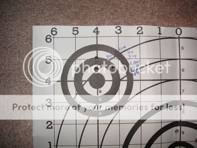

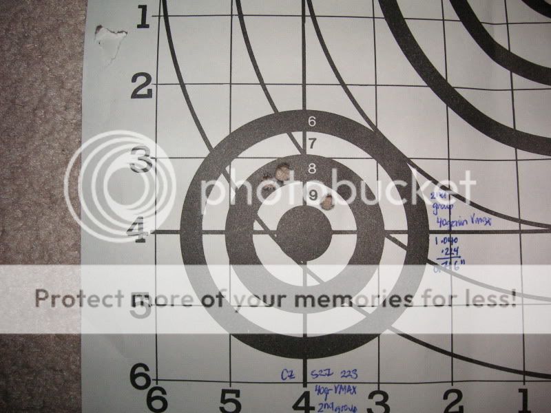

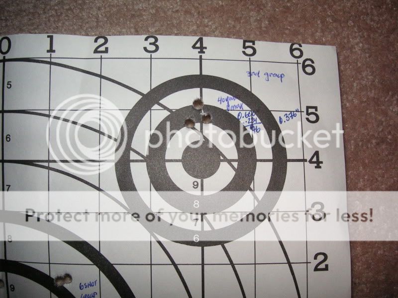

Here is a way to use three targets and confirm your POA at the same time. Three CZ 527 targets I fired with 40 grain VMAX at 100 yards.
Target 1:
Target 2:
Target 3:
You can see that the rifle (CZ 527 American Light Barrel) shoots quite well (1.5 MOA likely) and that my POI is about 3/4" high at 100 yards. Keep doing what you are doing and study your targets. Your rifle sounds like it has excellent potential if it can shoot AE into 1.5MOA at 200 yards. Frequently rifles that shoot well at 100 yards don't shoot as well at 200 and 300 yards... I have found that a 1 MOA rifle at 100 yards can become a 2-3 MOA rifle at 300 yards. That is the reason a lot of guys around here will tell you that groups up close (<300 yards) aren't a true reflection of the rifle's accuracy. Good luck with your new purchase...
