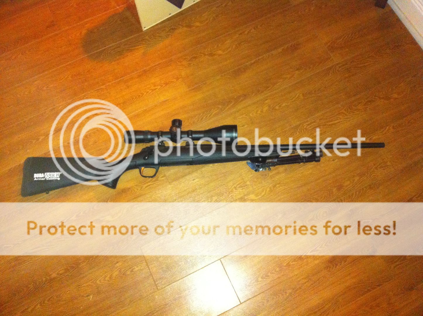

Your right I have a x-bolt in 308 and love it couldnt ask for a better gun for the money would of liked to see a 1 in 12, twosmokinspade would you buy it again?, I found one from one of the sponsor and also a local shop has a 243 with 3D stock kinda caught my eye but I already have ruger#1s in 243 and 6mm ?? Now to mak up my mind!!!!
We'll made my decision, called up frontier firearms and ordered an x-bolt in 22-250 I think there the only ones in canada that had one left! No I need to get so rings !
