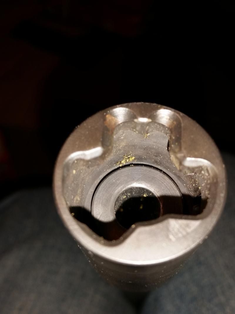

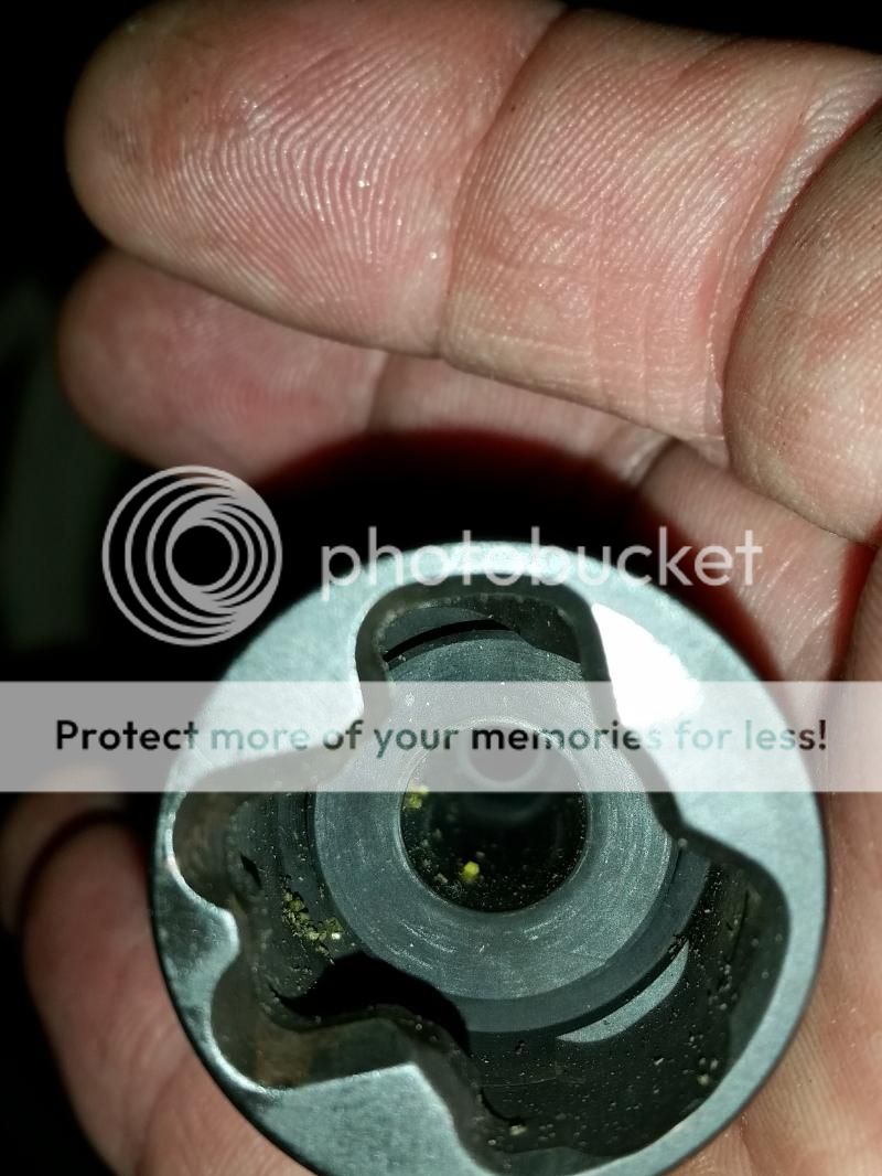

I just stripped the gun down now, the barrel is free of obstruction. There are a few grains of burnt powder in the breech, chamber and down the bore. No other material, the barrel appears to be in perfect condition.
