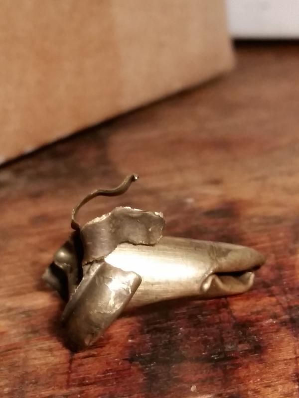

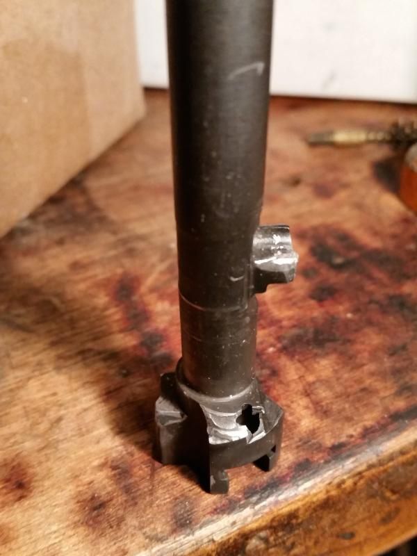

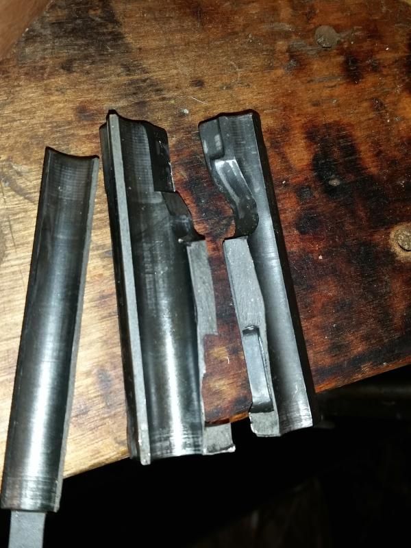

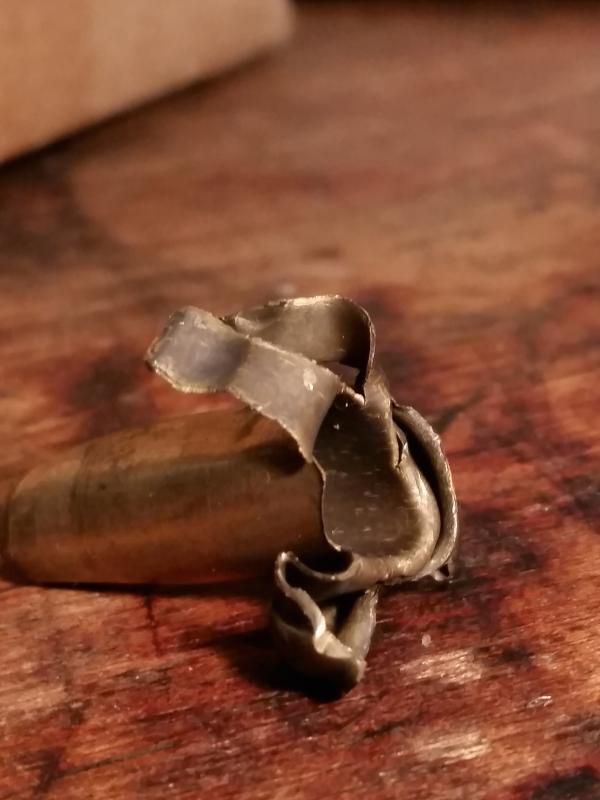

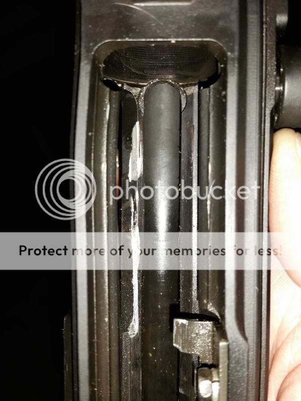

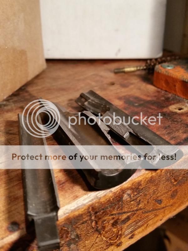

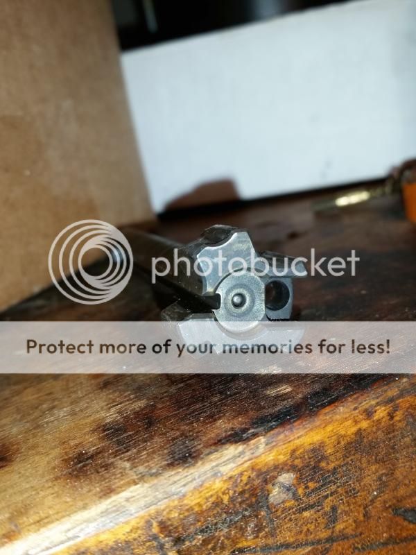

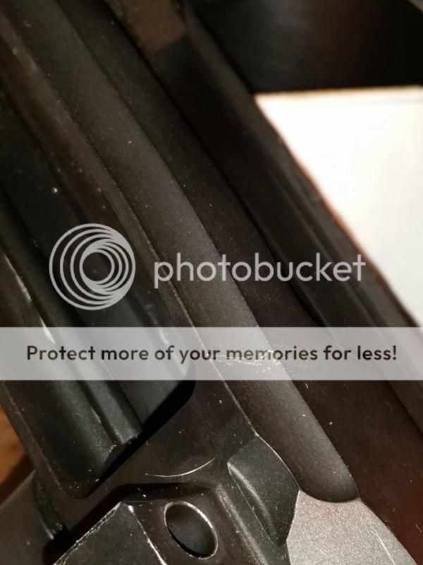

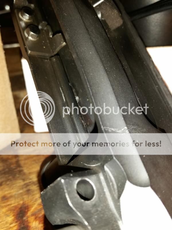

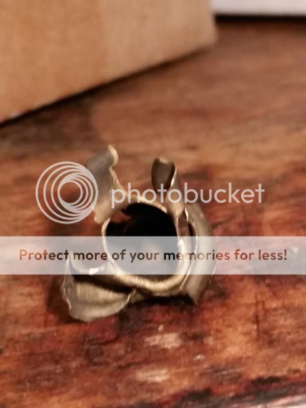

If a 'slam-fire' happens in an AR (lets say due to soft primers and the firing pin hitting it from inertia) the bolt is locked anyway so the bullet goes downrange (cuz that's where you had it pointed...right?)and despite being surprised, all is well. On an AR15 the firing pin can not physically touch the primer until after the bolt is fully rotated/locked.
It seems that in an XCR, since there is nothing mechanically stopping the firing pin from being able to ignite a primer before lockup (aside from a spring), if the firing pin happens to get stuck forward (let's say a build up of carbon?), your gun might explode. I'm not sure if it's possible for the hammer to ride the pin forward and cause the same result in an XCR?
Which isn't to say an AR15 can't blow up. A case head separation can cause that even if the bolt is fully locked.
Thanks, good explaination, pretty much how I thought it to be.
