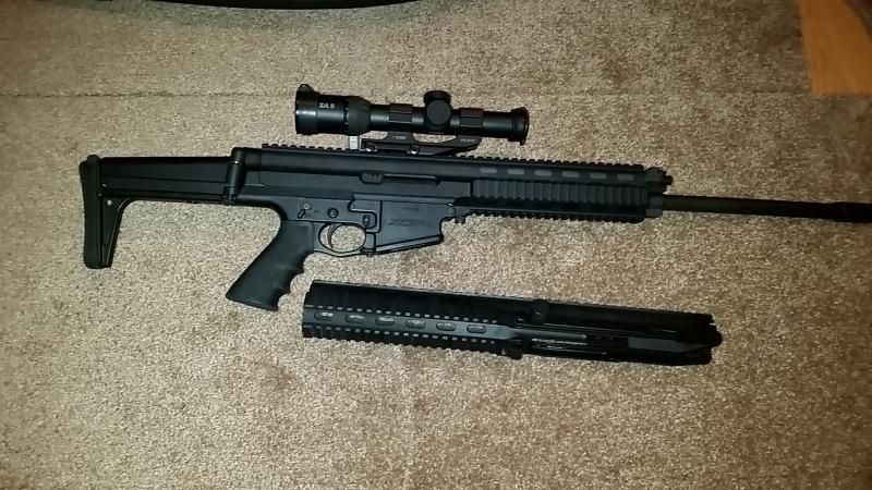

The manual specifically says that only new, factory ammo in good condition should be used....That being said, if one is going to reload, he should absolutely use NATO spec primers because they are hard and more likely to be to spec....This information was given to me by the company manager.
So factory Federal Gold Medal Match would be ok to run in the XCR, despite that ammunition using a Federal 205m primer (which happens to be about the 'softest' out there), and yet handloading ammo is no good, despite using a Winchester WSR primer, a primer which has had good success and fully in spec in semi auto rifles?
I can understand someone's trepidation in trusting the quality of a handload (was it sized correctly, was the primer seated properly, ensuring no 'high primers', etc.) but to load it all on the type of primer seems a bit...off...
