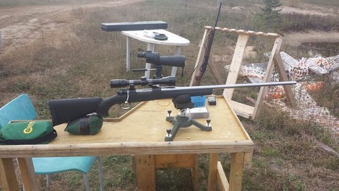

I went with the 26" Shaw short chambered they have in 9.3x62 and put it together on a spare K98 receiver, worked out quite well... good velocity, quite accurate.
The Shaw barrels are quite long, and heavier profile. Still haven't made up my mind on having it shortened, blued or some other finish. Eventually a nice laminate stock will finish it off, but the Hogue soaks up a bit of the recoil.

To my eyes that looks long, even more so for a 9.3.
2500fps with 286gr PRVI, and still 2 grains under max with Varget. that's pushing 4000ft/lbs of energy so I'm liking those numbers for the 26" barrel. I still need to find the perfect laminated stock, then I'll see if the barrel gets cut a bit or not.
My other 9.3 has a 23 5/8" barrel and is also a cannon.
Shaw 2 1/2 contour barrels are quite meaty. Heavy sporter, almost a light varmint. The 9.3 bore would reduce weight a bit, compared with a .22 or .30.
