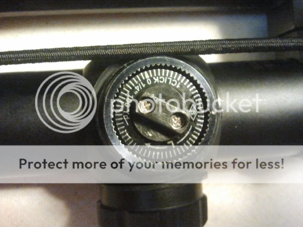

If you are hearing clicks, you are moving your scope's adjustments. You do not want to be doing this when you are trying to make your knobs read "zero" after you've sighted in your rifle.
Another thing you can do instead of attempting to move the knobs, is to put a small dab of liquid paper on your elevation and windage dial, to indicate to you where you line them up to return to your 100 yard zero.
Also, by far the most common scope adjustment click size is "quarter minute clicks", which means that one click will move the bullet point of impact by 1/4" at 100 yards (or 2/4" which is 1/2" at 200 yards, 3/4" at 300 yards, 6/4" or 1.5" at 600 yards, etc)

yeah the instructions made it sound like i had to move the ring, and i did, but that was wrong, had to use pliers. turns on the disc thats in there with the markings on it is what they want you to move, but you need to pop it up with a tiny screw driver other wise it doesnt move. so ive moved that and now its set to zero. just took some frustration and a headache to do so. :)
and yes the scope is a 1/4" at 100 scope.

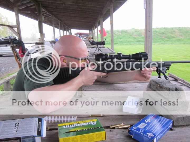

i used the bi pod and shouldered the rear, actually my buddy sent me a pic f me shooting
i was trying to stabilize the front from jumping around. it would go up and turn right, i found it was worse when i had my left shoulder more forward. so straightening out should help me, but the problem i was having is i couldnt get close enough to the scope to get a clear view through the scope without a little body twist. i was also shooting with my left arm under my right in a ##### cross trying to stabilize the rear of the gun a little bit. thinking back to it i think that was causing me more harm than good in the accuracy department.

It would be better to let your gun do what it wants. Don't fight it. Get yourself comfortable and stabilize the butt as best you can. With the butt into your shoulder as usual, curl your left arm back under the butt and cradle the butt in the crook of your thumb resting the hand comfortably against your body below your shoulder. It's kind of tough to describe. Play with this position until it feels natural and secure. Let the rifle jump all it wants. Don't worry about it. Remember, try to hold the rifle the same way for each shot. Better yet get a rear sand bag or something for a more secure set up.

that position description was pretty good, its similar to how i was holding it except i had my left arm under my right and was using it to support my arm and butt of the gun to keep it level with the target. does it matter the angle im at towards the gun? whatever feels good?
this is all great info guys, i thought i had to keep it from moving otherwise it would cost me accuracy. i appreciate you guys taking the time to write the information out and to reply to me.

+1 on everything @hend238 writes about holding and shooting your rifle. If you hold the rifle steady and break the trigger cleanly, your accuracy won't be hurt no matter how much to rifle jumps up and flies about. There might be other non-accuracy related reasons to try to control the post-shot rifle jump better (for example if you are trying to spot your own hits through your rifle scope, which you can do at 600 yards or more).
If the scope is a bit too far away from you there are a few things you can do to improve this. I see from the photo that you can't slide the scope further aft in the rings. You could get a different front base that will allow the front ring to move aft half an inch or an inch. A simpler and cheaper fix (and one that I would do right away) is to simply unscrew your recoil pad; this will move the scope, trigger and bolt half or three quarters of an inch closer to you.
