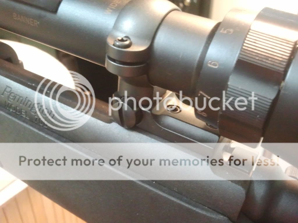

one more question, what are these screws for at the base of the ring?
i thought they were to secure the scope to the gun but that has its own screws when i looked under the scope. are they to raise the back or something?
Are those Leupold "standard" rings and base? If so, the screws allow you to adjust for windage independent of the internal scope adjustments... Back one side out and tighten the other side - to adjust right or left accordingly... HTH's...

@uchi as @highspeedlowdrag says those two big screws on the side allow for mechanical adjustment of windage. Also they hold the ring down against the base (have a look under their heads you will see they are conical).

ahh good to know about the trigger pull. i personally found while dry firing it at its heaviest setting i would get a little bit shakey in the hand as i was about to pull, the lighter pull wasnt giving me that issue. whats the purpose of having windage adjustment on the rails? i see elevation being beneficial but cant think of a reason why youd want the entra windage.
