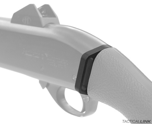

Seems that maybe there is some variation from one manufacturer to the next, in terms of receiver length and/or barrel length. The upshot of this is that a 14" 870 with bird's head grip will be right around 26", and you may need to add stock spacer to keep it legal.

If you're sure they're the same, any idea's how to get it to the legal length? Stock spacer or sling plate?
Thanks
Stony
Sling plate won't get you there it will only add about 3/16" or so....you could build up the back of the grip or screw an eye bolt in the back I guess or you could make a longer grip out of wood using a beater 870 stock like in the picture above.....
I haven`t done this myself, but I`ve heard of guys adding 2 or 3 sling plates, (plus a new longer bolt), in order to reach the required 660mm overall length.
Each sling plate adds about 1/8". If you have to add 3 sling plates, things apparently start to get wobbly. (Perhaps they could be JB-Weld'ed together or something.)
