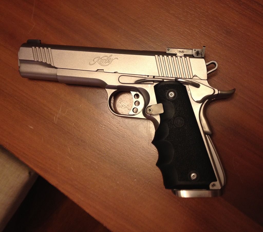

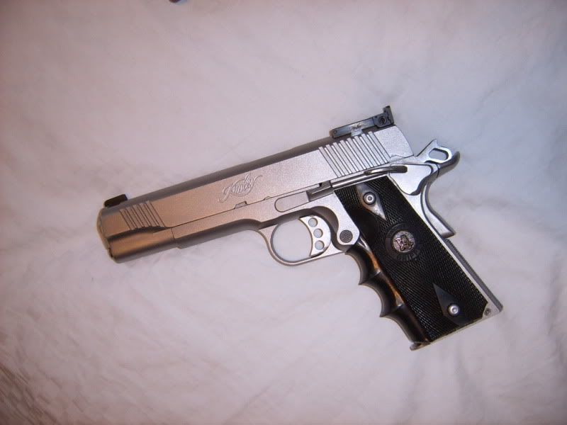

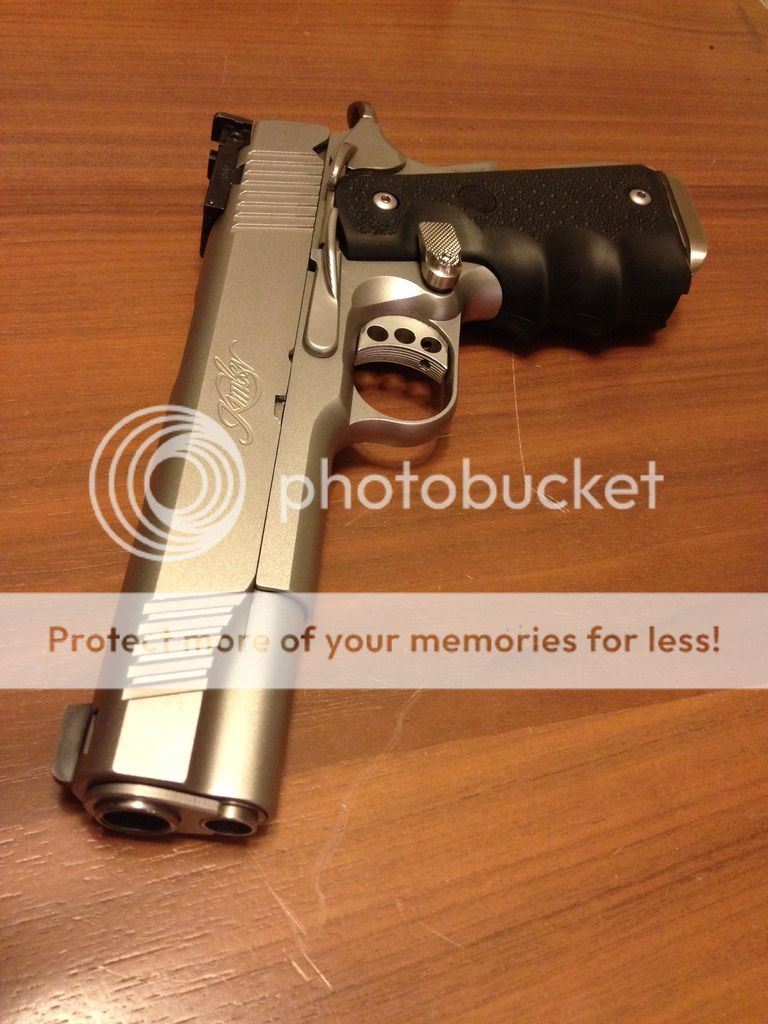

Did some work to the old Kimber tonight, now Iam in love again, This was the very first handgun I bought back in 07
before
After added a new arched mainspring housing, Magwell, oversized mag release, new grips, and extended slide release. Only Issue I've found is my ACT mags done work with the magwell
Looks good, Craig0ry. Do the mags not work well because the mag well extends down too long? If so, Kim Pro Tac (not the standard Kimber!) mags might be a good option for you as they come with 2 plastic bumper bads and one of them extends quite a bit, should be well below the magwell. They are good mags as well, can't yet say as bulletproof as Wilson or CMC but so far so good for me.

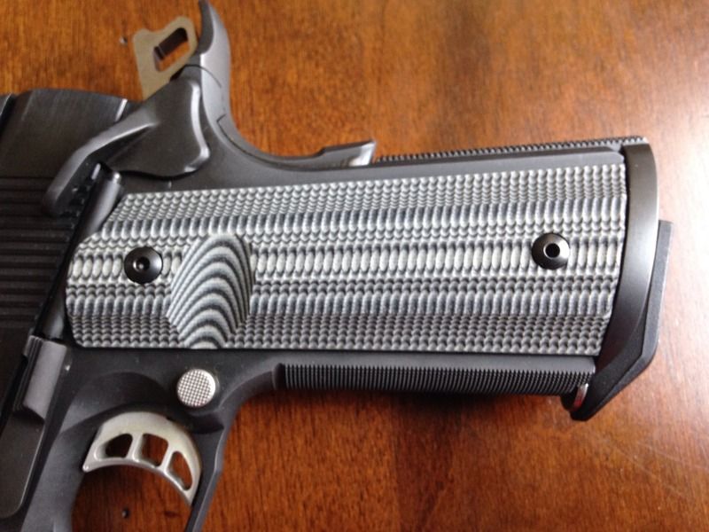

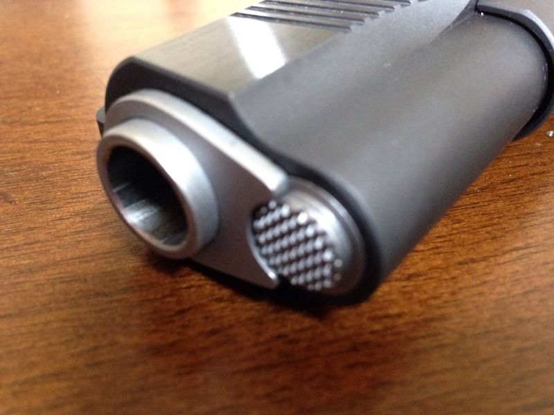

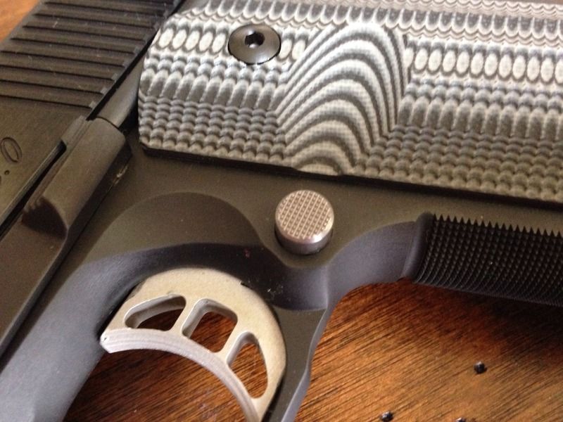

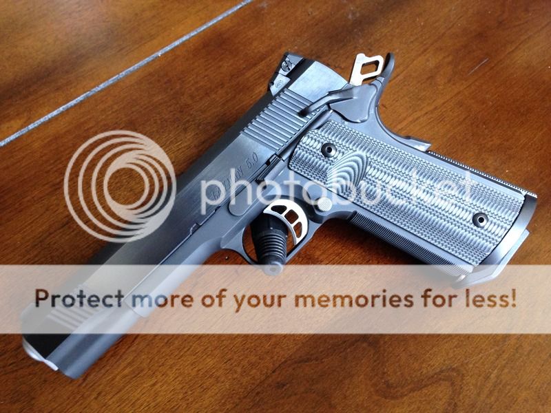

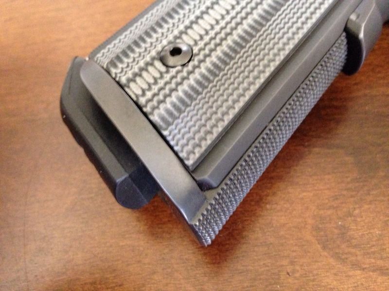

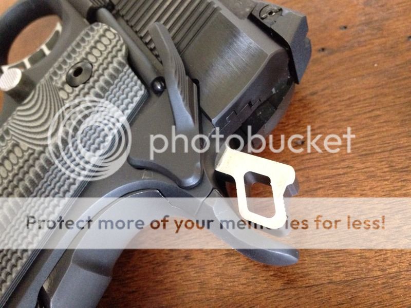

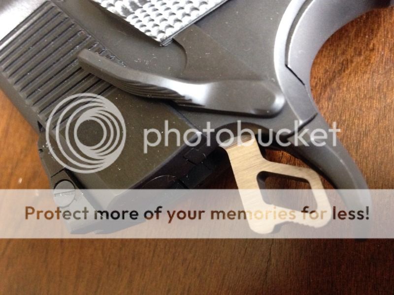

Done with my Lawman:
1. VZ Gatorbacks Grips
2. Smith&Alexander Magwell
3. STI Ambi Safety
4. STI Squared Hammer
5. EdBrown Extended Mag Release
6. EdBrown Recoil Spring Plug
