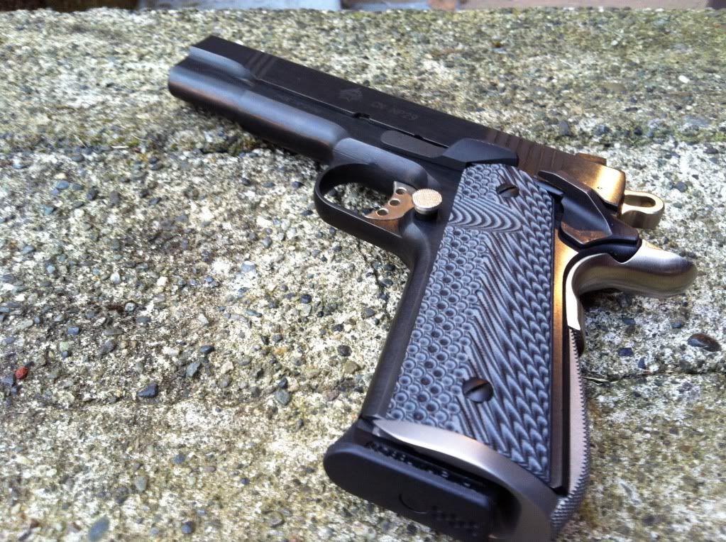

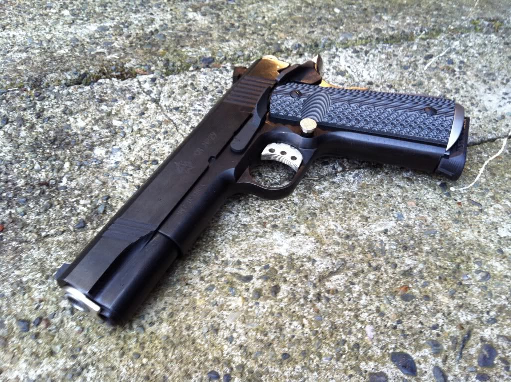

What a fantastic week in Kanukastan. Took my bran spanky new STI Ranger out for it's first spin early this week and put 414 rounds threw it (just a light break-in :) ). Not one failure of any kind! No hang-ups no feed problems, just as fluid as heck and shoots like a dream. The trigger was like nothing I've ever shot before, super light and as smooth as a prom queens thighs. Just total fun to shoot. The Bull Barrel and polished feeding ramp ate up two different grains and some hollow points that I just randomly mixed into some of the mags to really test the feed. I'm in love with this commander sized, full frame 1911 made by STI, an employee owed, smallish Texas firm. This coming from self confessed glock guy too!
So, now that I'm done gushing about the amazing functionality of this gun... I gotta say from an aesthetics pov, I didn't like everything about it, the matte finish on the barrel and the cheapish looking skeletonized trigger to name a couple.
Not so hot on the gray sad lookin barrel.
So yesterday I got out the Mothers and started rubbin... and rubbin... and rubbin and...
So happy with the final product, sharpens up the look imo :)

here is the before and after pics.
That looks amazing! What was your process to get it to that point? What tools etc?
Edit: To clarify, I like the way that looks so much that, I am now thinking of buying a Norinco instead of a Ruger just, because if I bought a Ruger I wouldn't try to polish it like you did lol.
