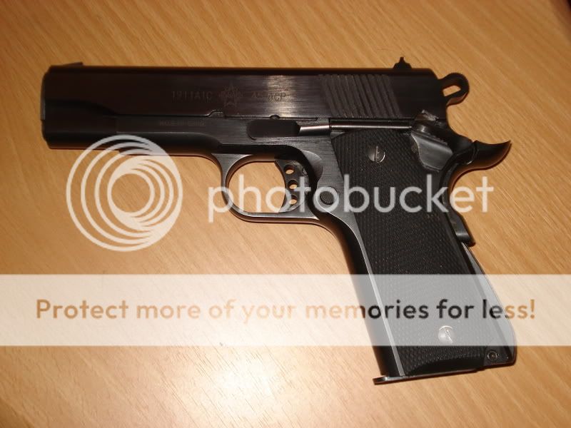

i just took my commander apart a day ago, cleaned it all up using kerosene and brake cleaner (way too much runny chinese oil), polished a number of areas & parts using 400, 800, and 1500 wet sandpaper (on a flat surface), put on some synthetic 75w-90 gear oil on pivots and synthetic grease on sliding parts, and put it all back together. rattles a lot less, slides a lot nicer, and trigger doesn't feel like it has gravel in it.
polishing done on trigger & guides in frame, frame / slide rails, a few surfaces on the sear & disconnector (though will need to take it apart once more to polish a few more surfaces). shaved off the ugly squared trigger guard using a bench grinder and need to slightly shave the slide release so that it fits into my Fobus holster (it sticks out to far and jabs into the holster). not changing any parts, keeping all stock stuff.
still need to shape the feed ramp since SWC rounds don't feed that well, and fix up the inner part of the slide release since it doesn't rise up to lock the slide back after the last round. the little knob on the inside doesn't extend far enough to catch the follower of the mag. JB Weld to the rescue!
oh, will change the grips to fat wooden ones, but that's about it.
