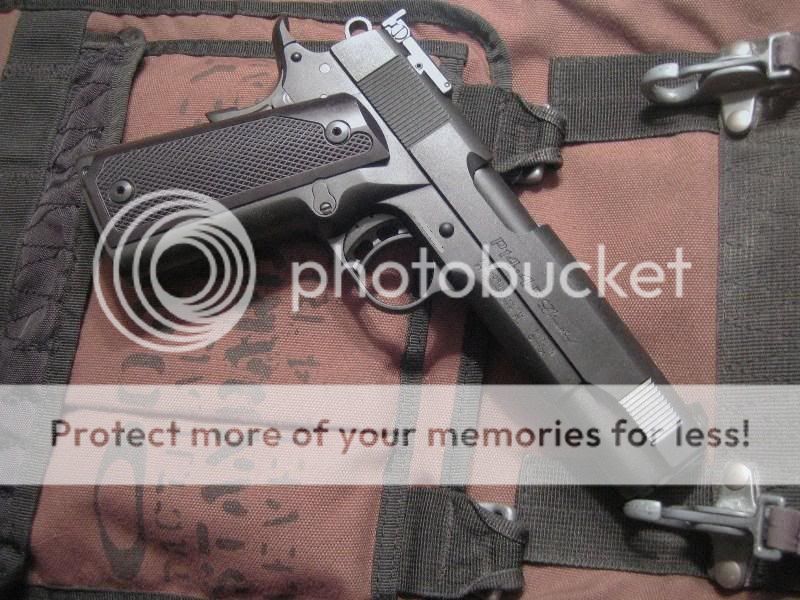

My latest project:
The parts are a mix:
Dlask
-Trigger
-Sear
-Safety
-Hammer
-MSH
Wilson
-Barrel Bushing
-Slide Stop
The grips are Alumagrips, and the whole piece has been dehorned. While it was a little unnerving to take a file to a gun, I must say I like the feel!
The finish is matte black and was done by Arma-Coat; I don't have the patience to be good at finishing!
