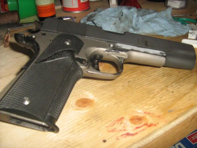

I humbly submit my latest acquisition. This is an older Norinco, and appears to have been around a great deal - I suspect it may look familiar to some of you! Yes, I snapped it up off page three on the EE. For me, though, this is the perfect gun. It's my first semi-auto, my first .45, and my first 1911. I was really looking for an entry level 1911 to learn on, and also to experiment with some refinishing, and that's just what I now have!
The frame of the gun came with an armacoat/spraypaint type finish, wearing off in the key areas. Upon stripping it right down, I discovered that all internal frame surfaces are also sprayed/oversprayed with this same substance, much of which came off with just a general oiling and wiping down. The stock hammer has been ground off to clear the beavertail, whose fitment was achieved with the same angle grinder used to shorten the hammer:) Thankfully, the frame was left alone, and just the grip safety butchered. The only other obviously nasty bit is the drilling of four holes per side on the forend to facilitate the mounting of. . . something large and ungainly requiring eight mounting holes:bangHead: The holes have cut off screws in them, and there was a strip of shiny aluminum cold-welded over top to cover up the mess.
Mechanically, the only concern is the barrel, which has some severe rust/leading issues near the breech. The shooting I have done has resulted in very bad leading, which I suspect is a result of the bullets being scraped undersize by this nasty patch of fouling. I have scrubbed and scrubbed, and while it is somewhat better, I suspect a new barrel is in order. A range trip proved that it does shoot. I fired about 35 rounds of homebrew, and all 3 mags ran well and locked the slide back when empty.

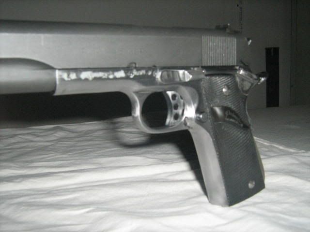

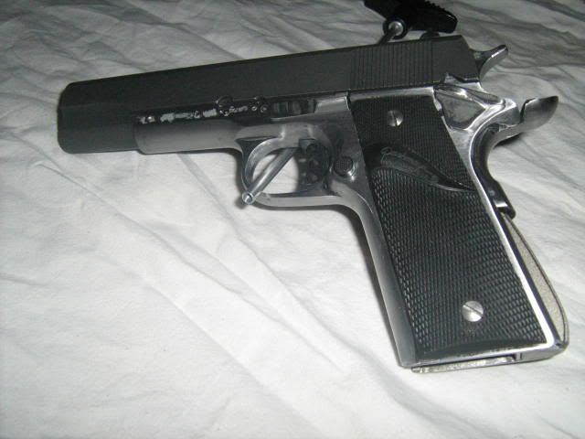

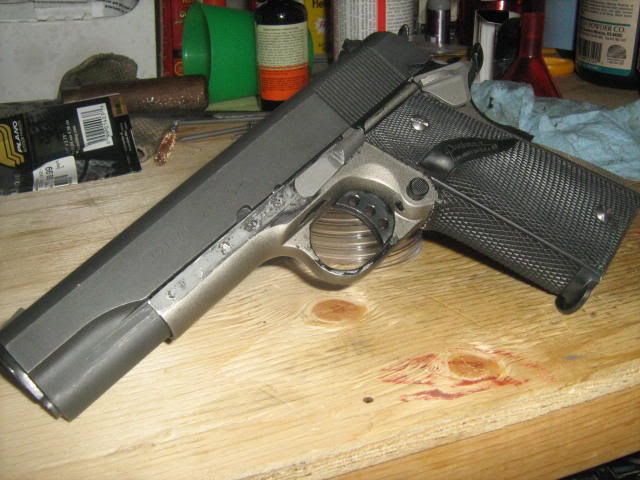

As this is a modifications thread, I have a few more pics to show that I have begun to (hopefully) bring this old piece back from the abiss:) I have removed the finish from the frame, and have begun to fit and polish some of the small parts. For now I plan to just fit and finish the parts I have, and see where that will take me.
With any luck, I'll also learn how to take some better pics as well!

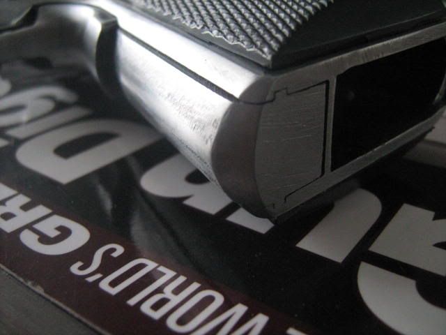

Mainspring housing now roughed down flat, ready for texture and finish. Also, I bobbed a little off the tail and squared off the base of the magwell and spring housing. Looks and feels much better.
