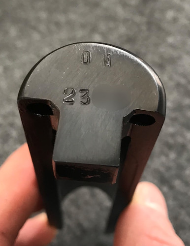

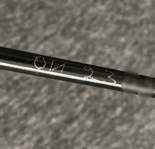

...and better pictures of the gas tube without the last two digits blurred out will likely demonstrate more of the previous serial that lies beneath the current one.

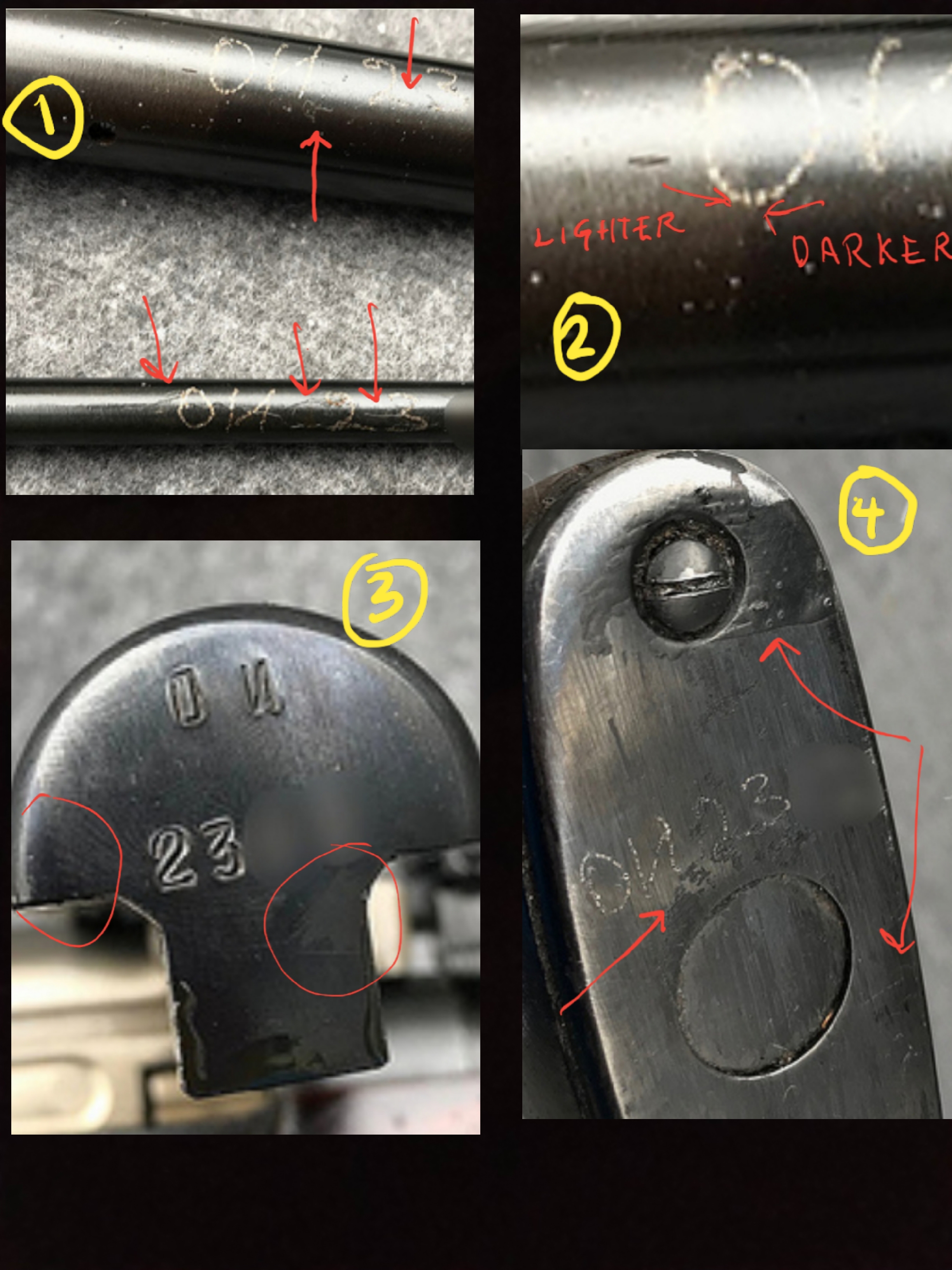

The arrow indicate the presence of a previous serial beneath bluing or paint on both the piston shaft and the piston tube:
Additional evidence of refurb paint, this time on the receiver cover:
This is pathetic... There is no EP serial under the old serial... that is dust and hair from the blanket... also several collectors have already examined this rifle in person and in detailed full pics and there is NO number under that number. That last pic shows zero paint.

It doesn't look like dust or blanket hair in the photo. Not at all. Looks more like blued over/shadow ep serials from a previous rifle.
I don't know, pcvando. Better pictures might help. But it sure looks like chipped paint over bluing. One of the other types of paint that is found on soviet refurbs is a high gloss polymer similar to permablue. Even in person it looks almost like actual bluing. Of course a full length photo of a prominent annealing stripe on the receiver cover (with serial in the same shot, of course) would go a long way to proving that at least the cover may not be re-blued or painted.

Just to compile it in one post reply, here are the issues I have with your purported all original/non-refurb/as-issued carbine.
1. Evidence of likely previous serial numbers, overblued or painted over. We've all seen hair, fiber and dust in close up photos. Everyone else can judge for themselves, but these don't appear to be any of the three.
2. Clear delineation between original blue and reblue on gas tube
3. What looks like obvious indication of chipped paint (remember not all Soviet refurb paint was the cheap bbq kind)
4. Most glaringly obvious red flag: chipped paint on the buttplate. With the paint mysteriously applied OVER the EP serial. (???)

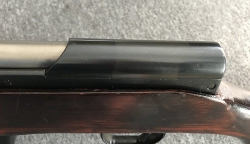

The paint you are seeing is not the Russian arsenal BBQ refurb paint. It is paint applied by the importer or exporter slapped on to protect from rust during the storage during the export import to customer process. It rubs off with your fingernail and comes off with simple gun cleaning supplies leaving unharmed original finish. Some of the as issued non refurb guns had rubbed areas on the butt plates from rack storage. Thus the blue is thinner or worn on some places and the paint was used to protect those areas for the export import process. Was commonly done to the ones imported to Canada.
You'll never convince true believer, this guy has no idea on what refurb is and comes up with some self-invented terminology like "rearsenal treatment". He also clearly has no idea how exactly refurbishing was performed and substitute lack of knowledge with fantasies.
This flaking paint is not a part of refurbishing as we know it. I saw same paint on guns many year ago in Ukraine when I was part of this business. I was told it was "pre-sale" preparation. Sloppy paint was usually present on lightly rusted or rubbed parts on otherwise OK condition rifles and could be easily removed. Pre-sale prep is might be the case, there's another explanation as well, again not related to refurbishing. At the storage facilities where rifles end up either after arsenal or factory (if there's no need to inspect and refurb) there are inspection procedures, don't quote me but something like once in 5 or 10 years or so. Every crate is opened, rifles inspected, date and signature to the packaging list. During this inspection minor issues like surface rust can be fixed on spot with this paint, nobody would send a rifle to repair arsenal from storage facility just to fix surface rust on the buttplate.

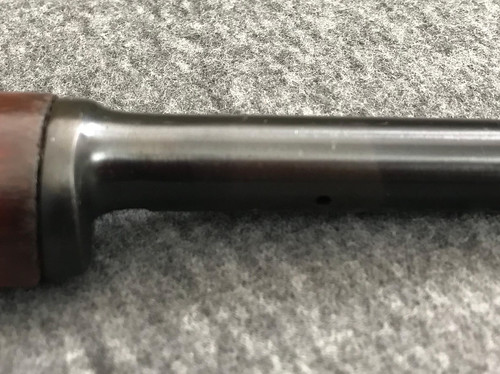

You sensationalize a piece of a hair or dust on the piston, and a finger print smudge on the top cover.
Here are the photos you requested, the lighting is not the best but it will do.
I am thoroughly convinced you will still find some way to find fault, where none exists. You should write Justin Trudeau's speeches, a lot is said but he really isn't saying much, just jumping around the same non-issue topics.
Piston:
Top cover: (As you can see, annealing stripe is nice and visible.)
Top cover: (Zero signs of anything you talk about...original bluing, white halos around metal show nicely at a better angle)
Gas tube cover: (Notice the annealing band around the vent ports, which is proper heat treatment for rifles.)

1. a better, HD close-up of the (hair/fiber/dust) EP serial on the gas tube.
