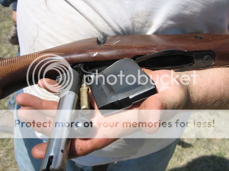

The only downer to the day was when Drew Carrey's .223 exploded in his face
Werent sure what happened while we were in the field...at that point it looked like a round detonated in the magazine!!
Once we got home I looked at the chamber with a bore light, and I was able to see that there was a partial case inside chamber...so it looks like a case of a weak case...causing case head seperation! The blowback caused another round in the mag to detonate, which blew arpart the magazine, split the stock, and give Drew some nice powder burns on his face!!
One of the scariest things I have ever seen in my life! I really thought that Drew was going to be seriously hurt!! Luckily he suffered only some burns to his face, and a cut on his hand...
So everyone please remember to check your cases, and throw out any that are showing signs of damage, weakness, or you arent sure about!!
