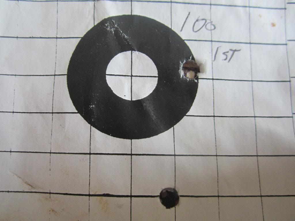

Anyway here are the photos of the 90 gn groups...........draw your own conclusions..........Grid is 1/2" squares.
Possibly you feel only 2 shots tells one nothing but I have learned over the years playing with wildcats and having sometimes very limited resources that 2 shots can be very revealing............as I believe these are.
Here are the 100 grn loads and I must apologize for all the extraneous holes but again limited targets and time and several rifles to test. I also got screwed up on my bulls on one group and it is indicated as such........
I actually shot these groups first and attribute some of the spreads to my shooting, I know I settled in better to the second rack with the 90 grners............again, draw your own conclusions..........

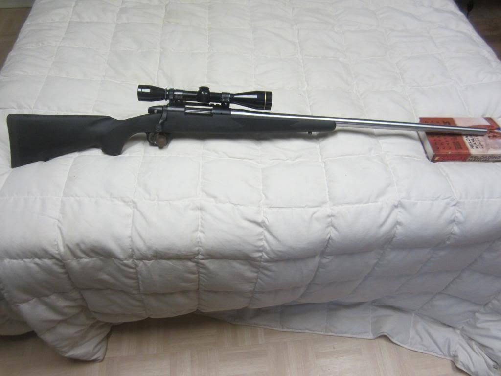

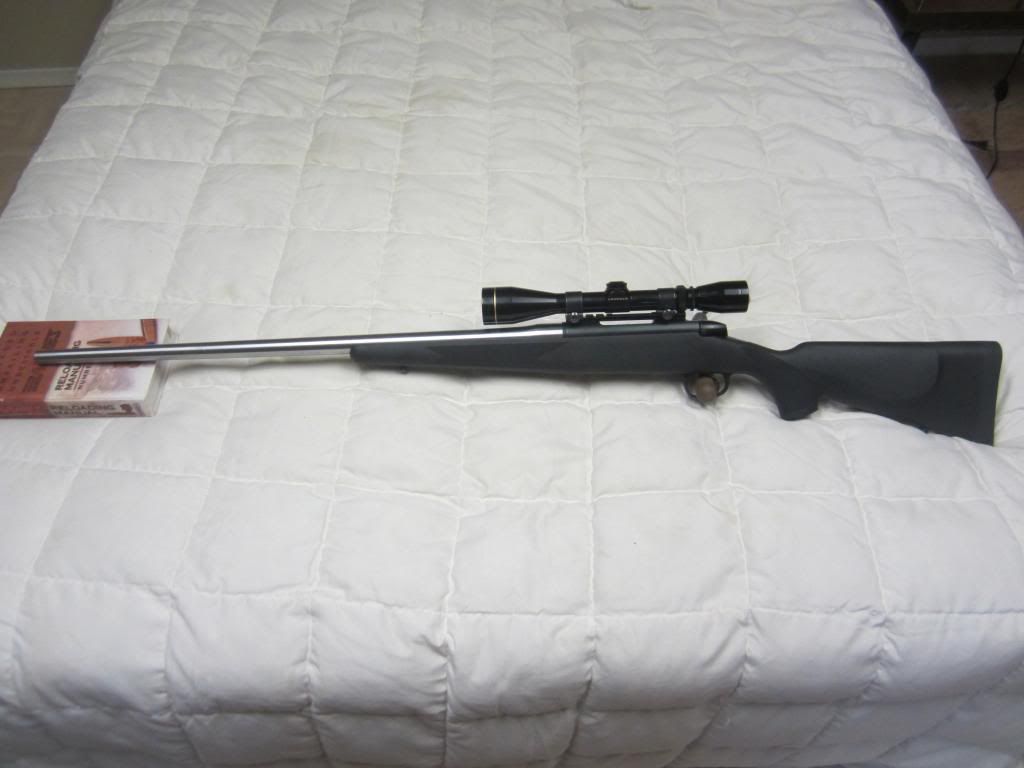

And finally here's some photos of the rifle...............
Barrel ended up being 27 1/4" long at this point and measures .715" at the muzzle
We must also remember the rifle is just bolted back in the original stock, no bedding, the recoil lug is not perfectly indexed, I never even adjusted the trigger, but it's not bad as it is clean and crisp at about 2 lbs, these are the first 25 rounds down the tube and as I said I have no idea what the jump to the lands is..........
