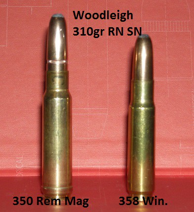

A 310gr would be a good bullet for the 35 Whelen except these typically have a 1:16 twist which won't stabilize it properly like my Remington 7400 autoloader. Winchester got it right with the standard 1:12 twist in the 358.
I also load the Woodleigh 310gr RN SN in my custom 350 Remington Magnum SI [Slamfire Improved ;)] Remington 798 which was built on a long action for increased cartridge OAL and with a 24" 1:12 barrel, and get a muzzle speed of 2500 fps.
350 Rem. Mag. Custom Remington 798 with Leupold VX-2 Ultralight 3-9x33mm

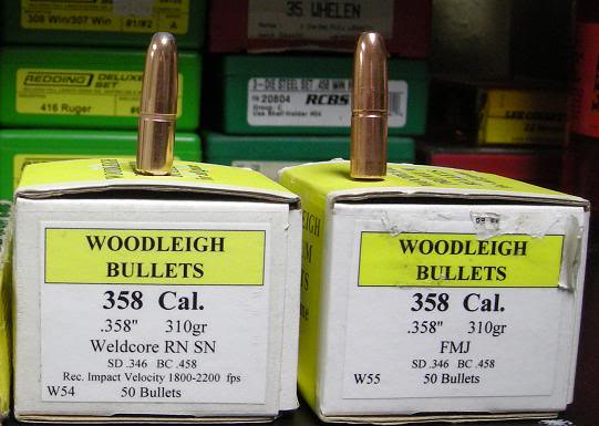

Recommended impact speed range for the Woodleigh 310gr RN SN is stated as 1800 to 2200 fps. From my 358 Winchester at 180 meters the bullets struck at about the lower limit speed. Likely to have expanded because of the round nose design.

Rather than flirt with the minimum speed for proper bullet performance, I prefer to launch a bullet balanced to the case capacity. The 225 Part from the .358 Win obviously carries more speed, in fact, more speed at 300 yards than the 310 at 160 yards... but it also carries more energy than your overly bulbous choice, at all distances, a sure sign that you are just trying to get too much from the case. If a 310 is what you will use, just choose a case better suited to launching it... JMO... I know that to be cool in certain crowds the rounder and heavier you go the better... ironically that crowd tends to be "rounder and heavier."

The 310gr has more energy and momentum than the 225gr at all ranges -
Momentum yes, energy no... did you chrono those numbers? Because a case full of 748 moves the 225 @ 2475 from a 22" Ruger barrel, but I could barely squeak 2050 with a 310.
