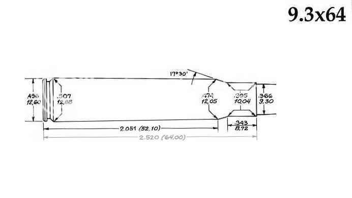

375 Ruger Brass
Ruger cartridge/case specs. COmpare them to your Brenneke specs.
