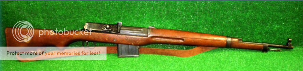

I talk to the seller , the rifle I'm looking at is a 1943 Ljungmann ag 42 with the ag 42 stock and small comp barrel but it's chamberd in 8mm. Could it be a ag 42 rebarreld in 8mm in Egypt?

Seems strange and it wouldn't make a lot of sense. I would have a look at it up close. I've had people insistthat their Enfield M17 was a 303. Not.

When you next look at the rifle, check it over thoroughly. There should be some stamps on the receiver stating what it is (a crown stamped there with a date in the 40's would make me think it's Swedish) . There are other things to look at too...is the gas adjustable? Swedish rifles are not normally adjustable. There are a few other differences too, but the parts could be swappable. I know the magazines interchange (Ljungman have a hasp on the front of the magazine, Hakims don't), and possibly some other parts too (bolt/receiver covers).

...Looking at this pic alone, it looks very Swedish. Stock disk, front sight, hasp on the front of the magazine, and non adjustable gas port.
That doesn't mean it's not in 8mm, but I would certainly double check. The 2 bumps on the cover are def. Swedish, and not Egyptian.
Both the Hakim n' Ljungman are pretty nifty rifles, and cool you got one. I would certainly consider slugging the bore before firing it! I know stranger things have happened, but I have a hard time wrapping my head around putting the effort into converting a Ljungman to 8mm when so many Hakims are out there.
Sure looks AG42 to me. I wouldn't try to ram an 8mm in there till I had a good look at it. I have a Hakim and they are not the same.

A set of calipers on the muzzle will tell you what you have there, it's not hard to tell the difference between 6.5mm and 8mm.
Mark
Sounds easy, but the muzzle break/flash hider makes getting calipers into the bore tricky. Pushing a slug through one is definitive.

Originally for the Swedes? I would doubt it. 6.5x55 is a Swedish thing ( and such a fine thing indeed). There must have been proving rifles to hook the Egyptians, but that would have been late/post AG-42B production.
