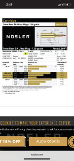

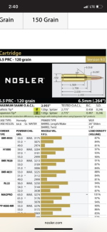

So here’s the 7saum and 6.5prc case. I wonder if a guy could run a prc case through a sizing die and load them up?
I was just looking at brass and lapua 6.5prc brass is $240/100 and adg 7saum is about $280-290
Yep thats all you do, expand the neck to 7mm and off you go. Its that easy.
