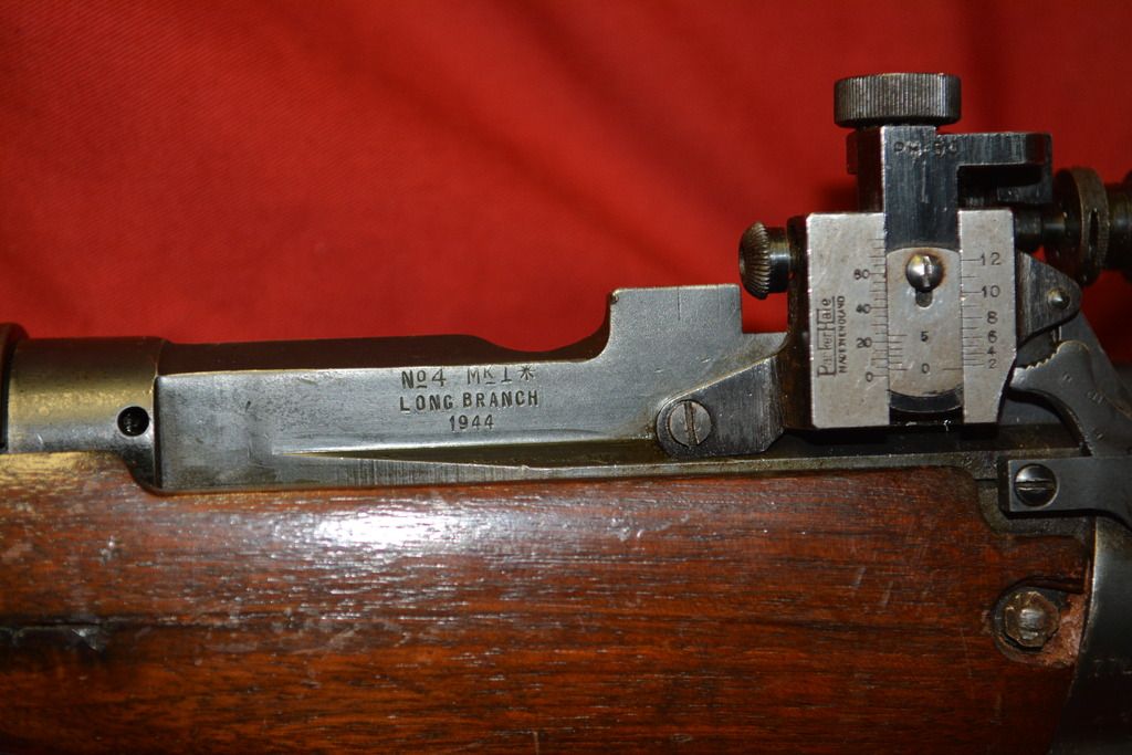

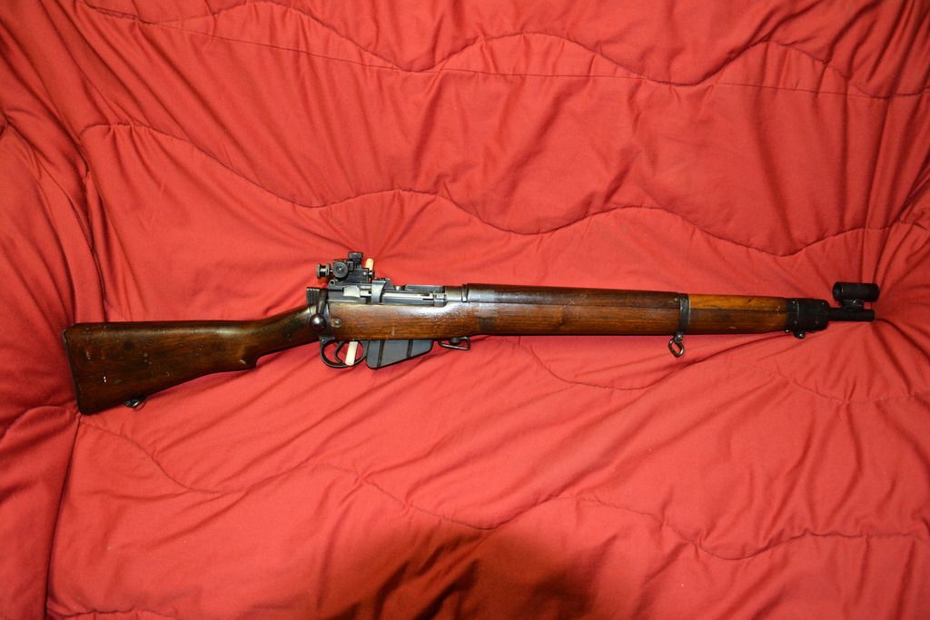

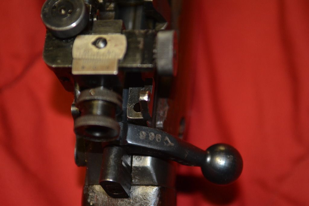

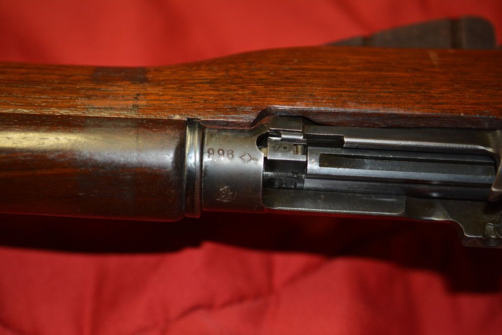

Longbranch Lee Enfield DCRA Conversion #996
#996 has found a home in Edmonton. No 4 Mk1* Longbranch 1944 conversion to 7.62 Nato. It has a matching bolt and a PH-5C rear. Bore is in pretty good shape.
