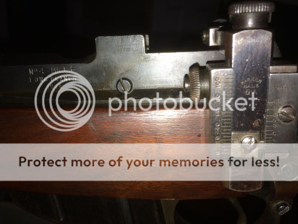

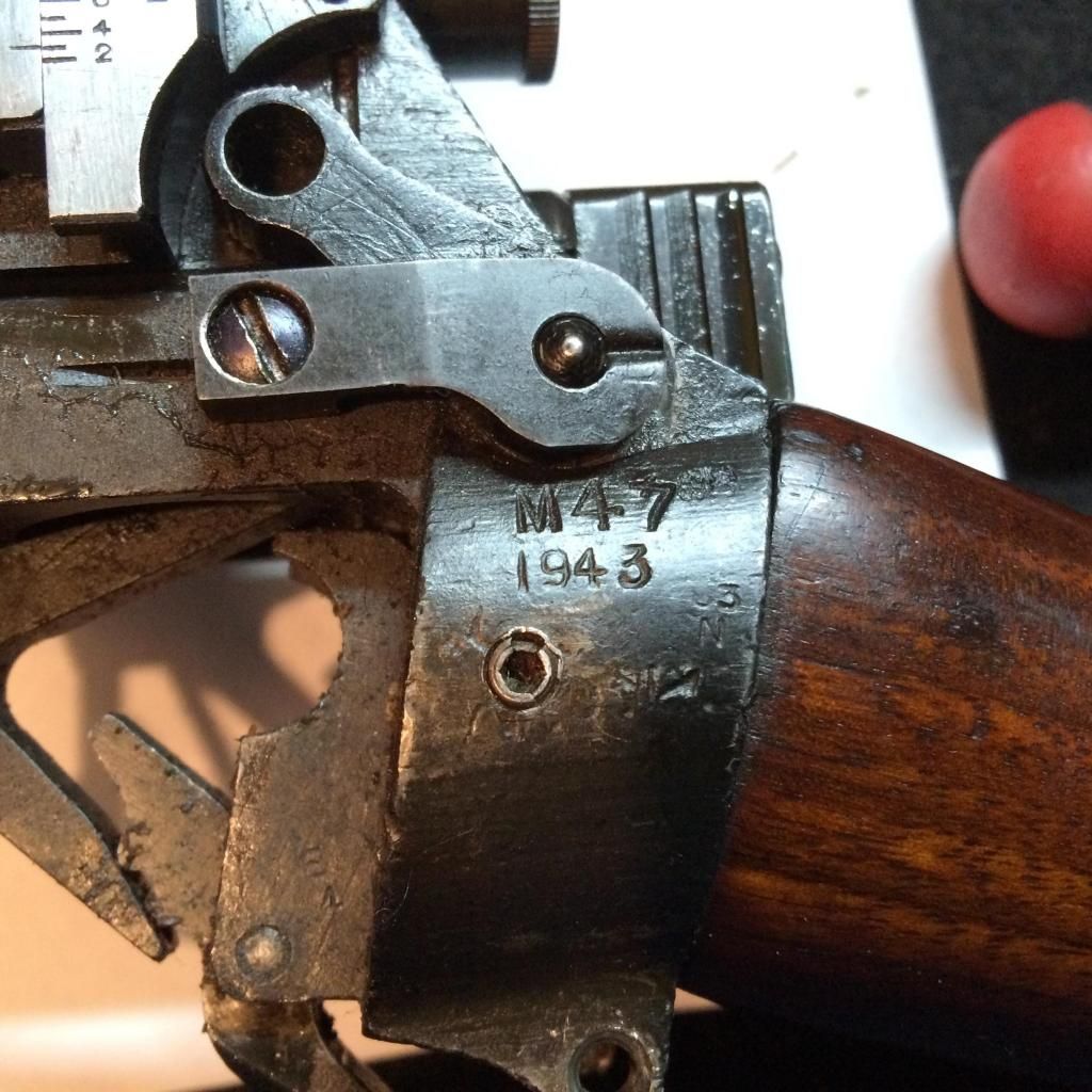

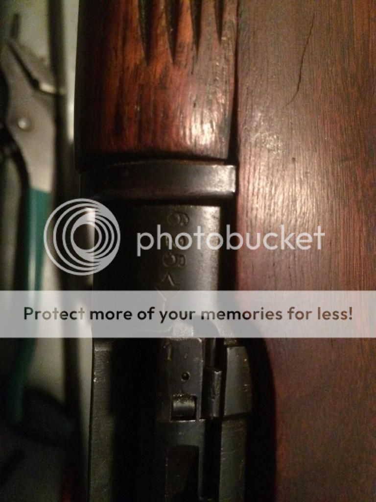

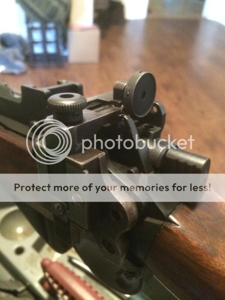

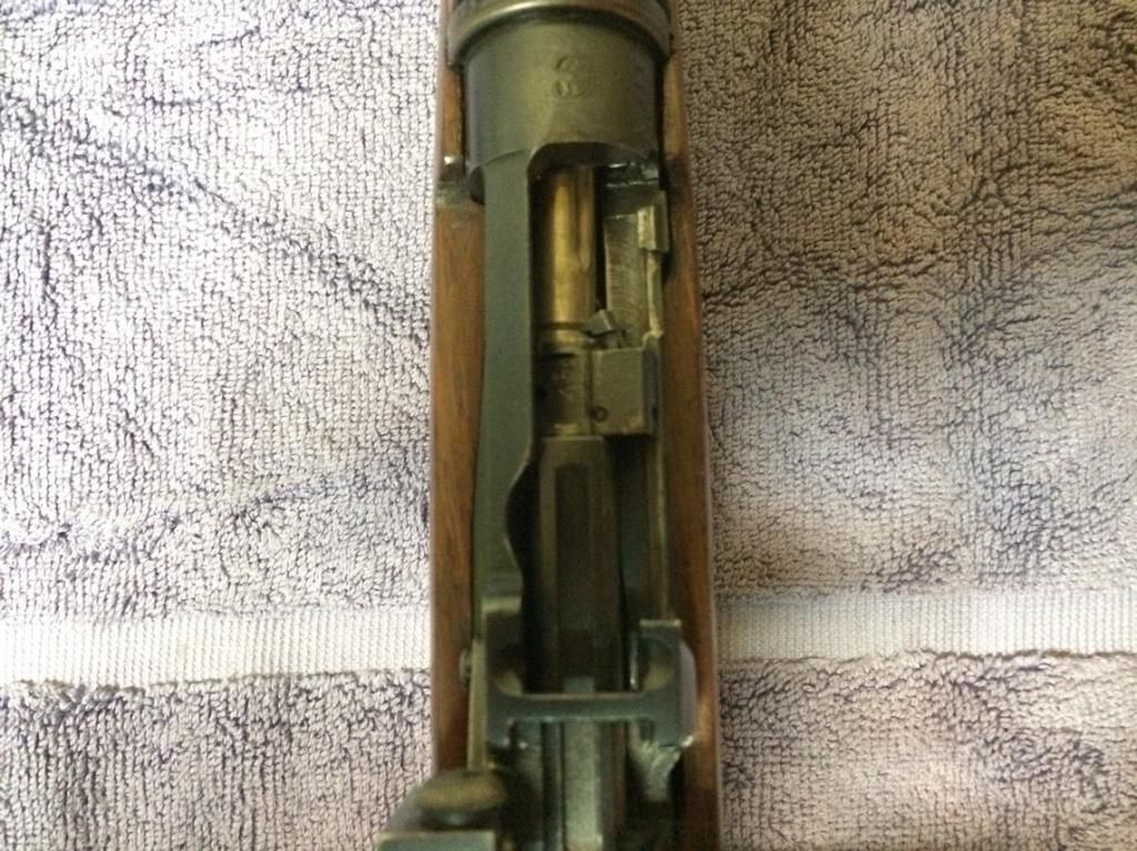

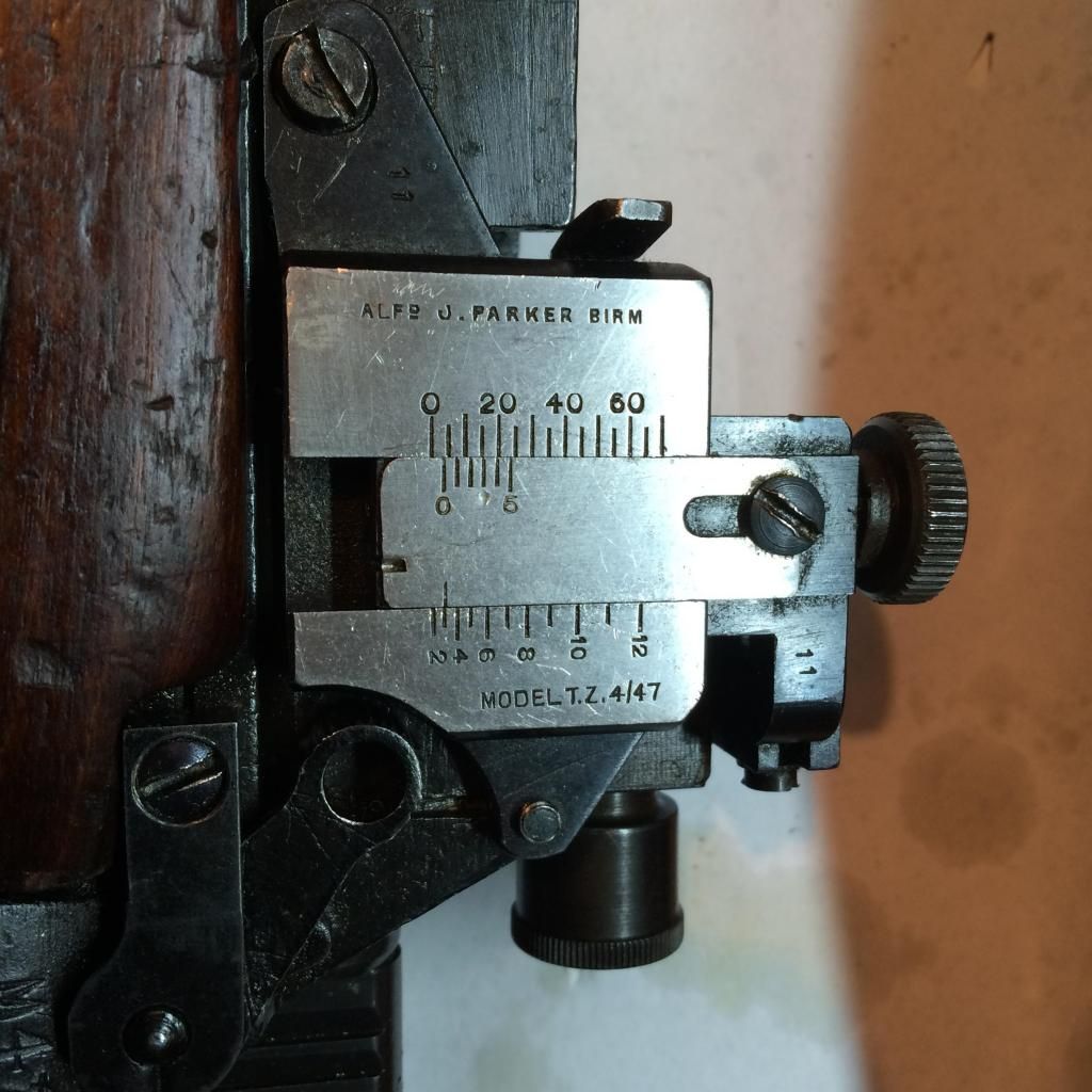

#1199 /Long Branch' 43 has been undergoing reconstructive surgery. A previous owner had milled off the back top of the receiver to force the fitting of a Parkerhale PH5A sight. My gunsmith has rebuilt the missing receiver steel with TIG welding then worked it back to it's original conformation so that regular #4 sights and scope mounts can be fitted. This is what it looks like now (I still need to reassemble it):

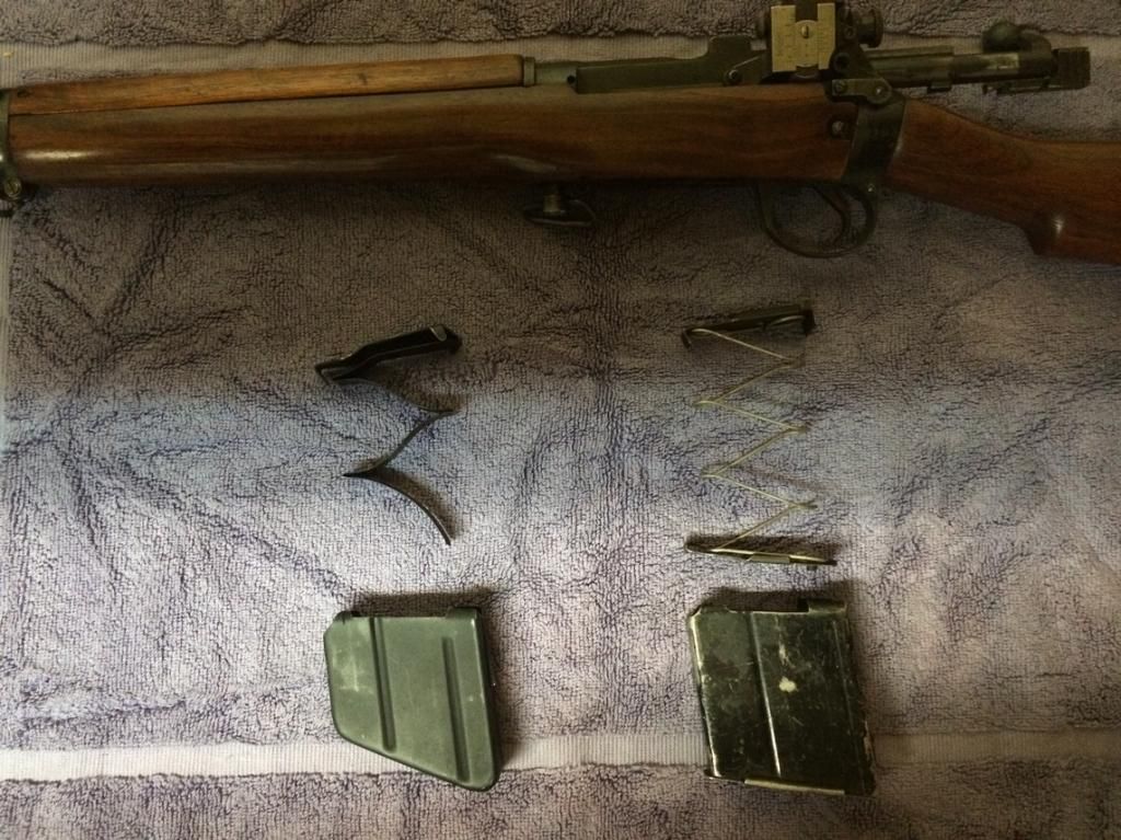

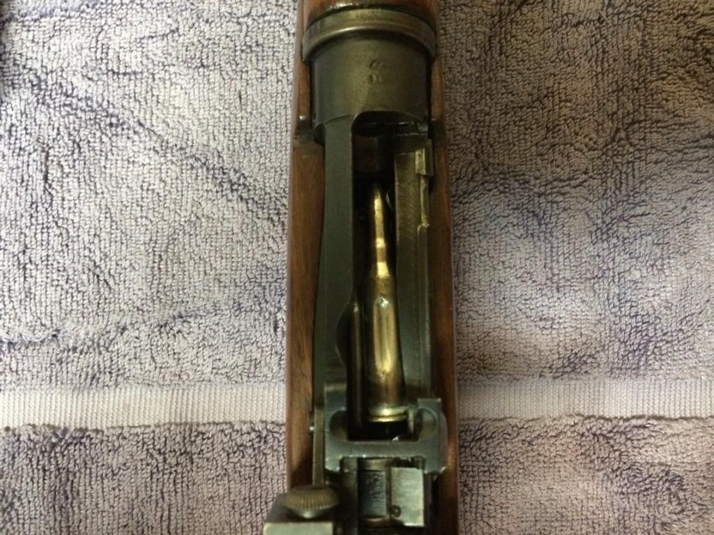

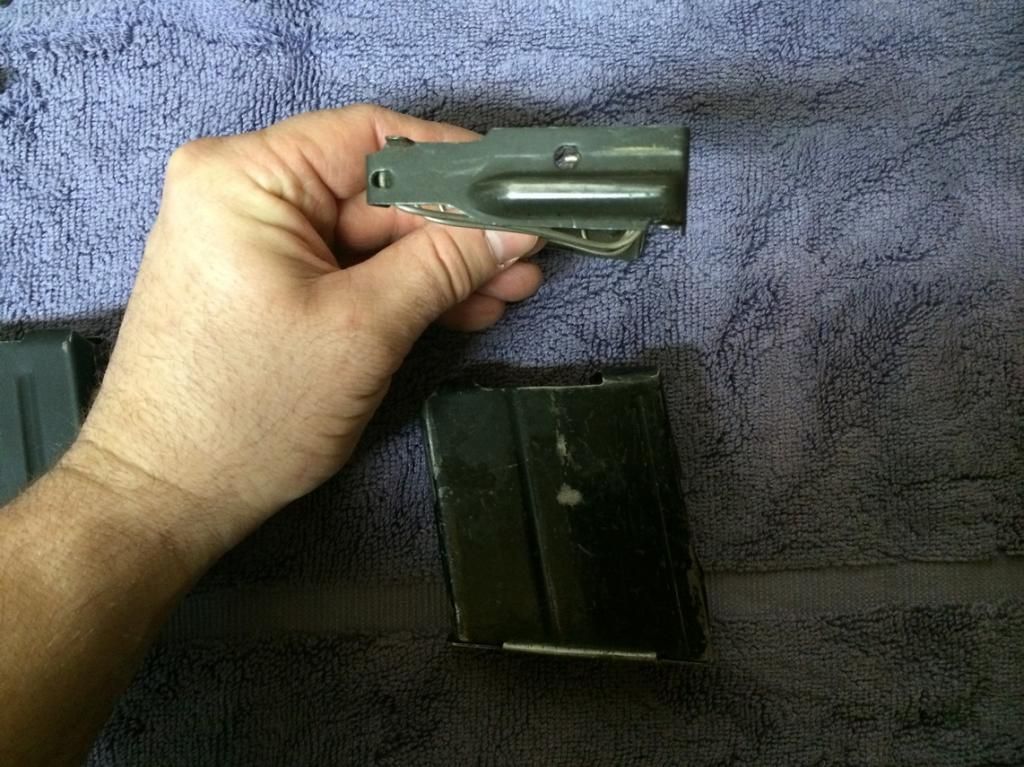

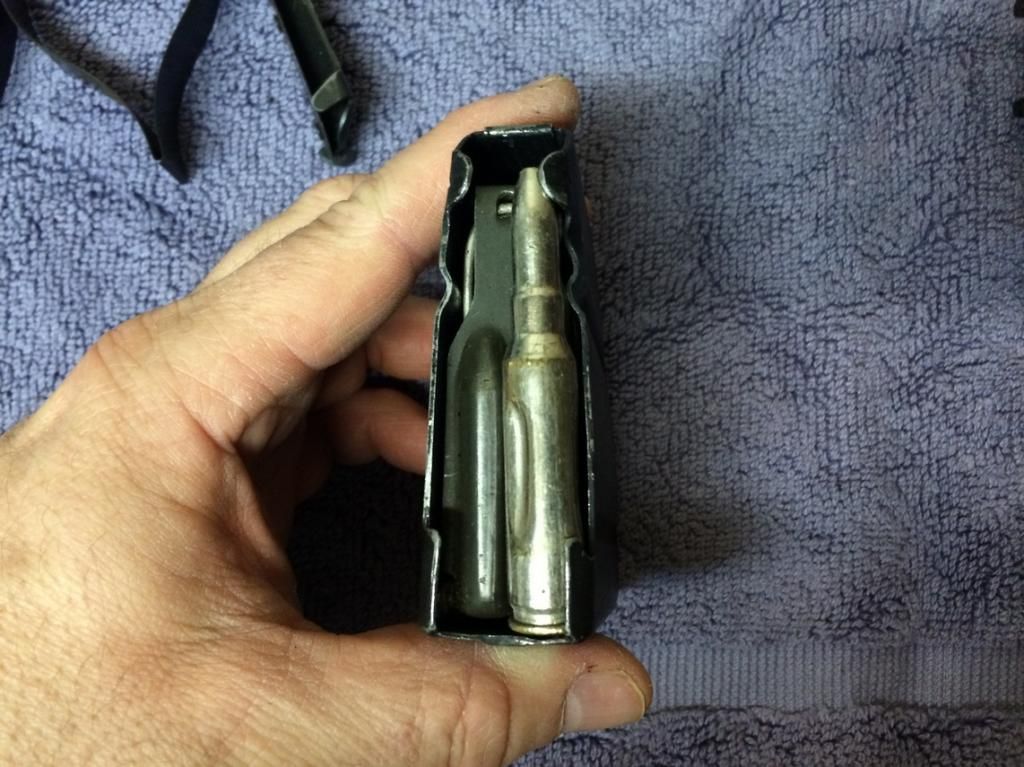

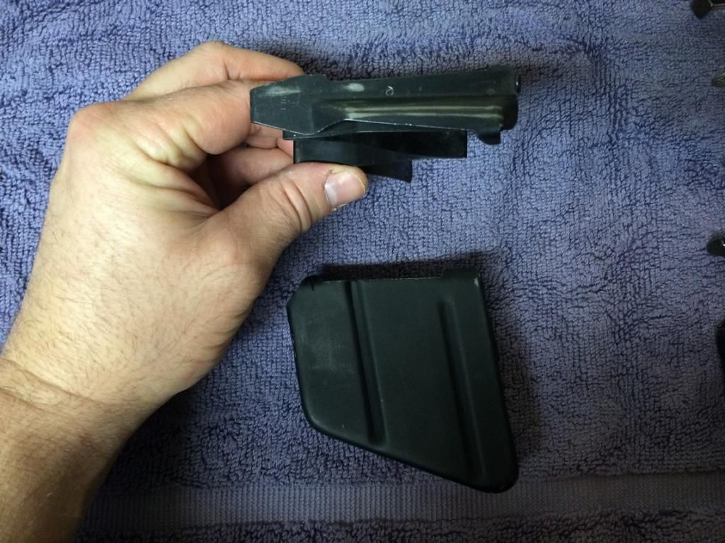

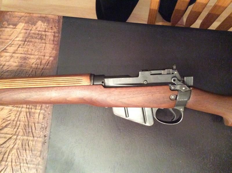

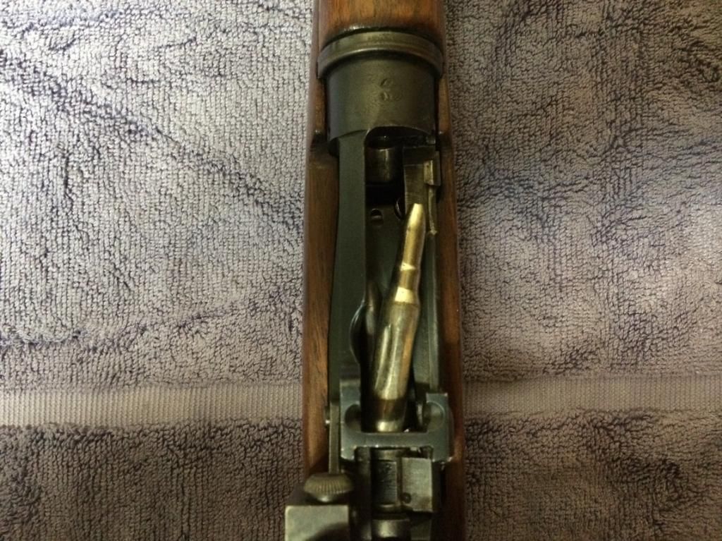

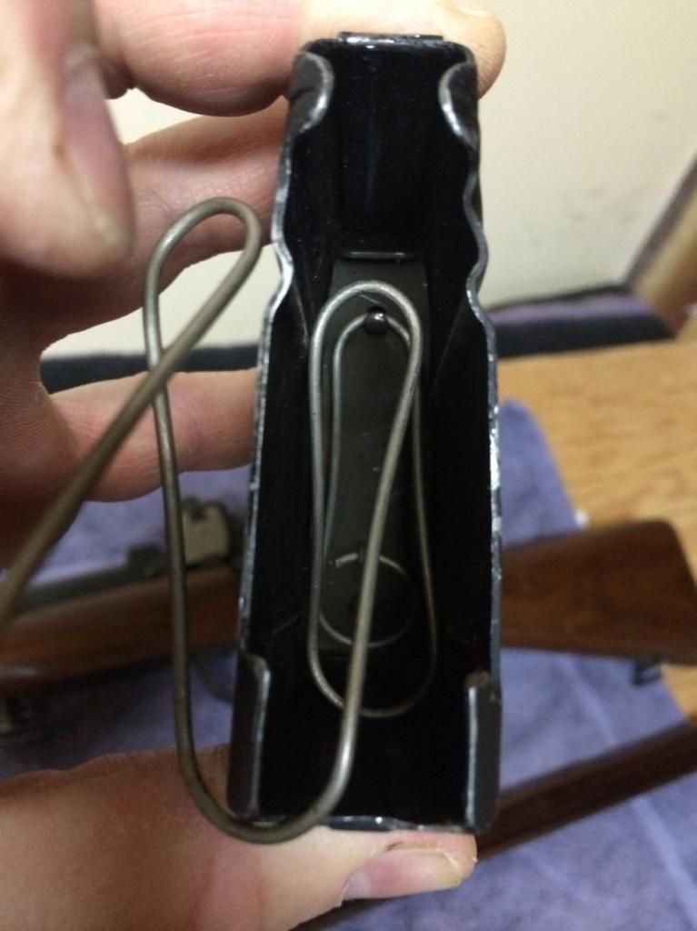

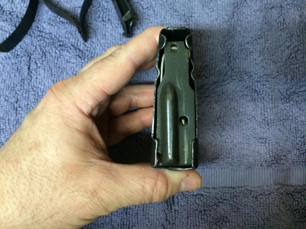

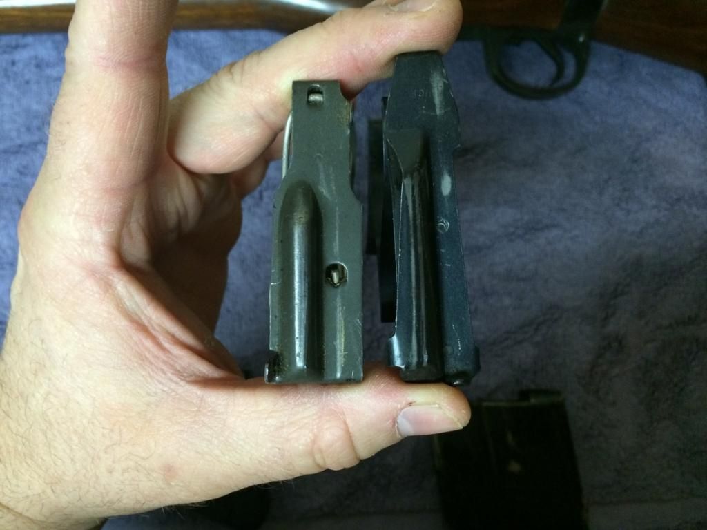

This may have been discussed here or in other forums, so my apologies if that's the case. When I acquired my DCRA rifle and took it to the range, I was extremely impressed with its accuracy but not thrilled about having to feed each round in manually. So I looked for a Sterling mag for some time without any luck and thought even if I found one, they are outrageously priced and they're kind of ugly (in my opinion). Or maybe it's that they ruin the classic lines of the Enfield. Nevertheless, eventually I found an Ishapore 2A1 mag, so I picked it up for a reasonable price. With some adjustments to the feed lips it fed just fine. But those mags are really ugly. So I got the idea that maybe the spring and follower from the Ishapore 2A1 mag would fit into the .303 mag of the DCRA rifle...
