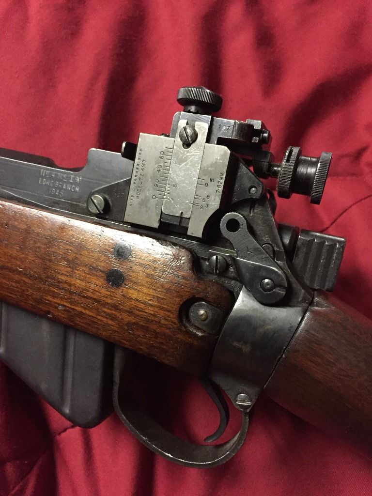

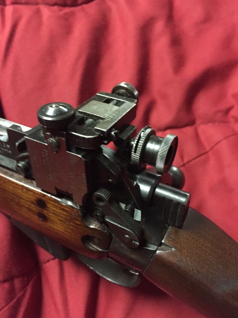

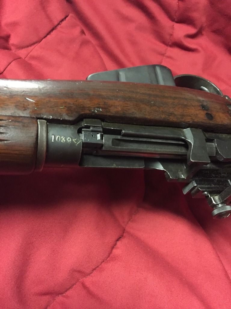

Just flushed one out of a closet:
1942 Long Branch DCRA # 1459. LB # 22L5787 5C P-H, 5G electropenciled on lh wrist, also C inside oblong circle same place, P-H front site cover List No. 134D.
