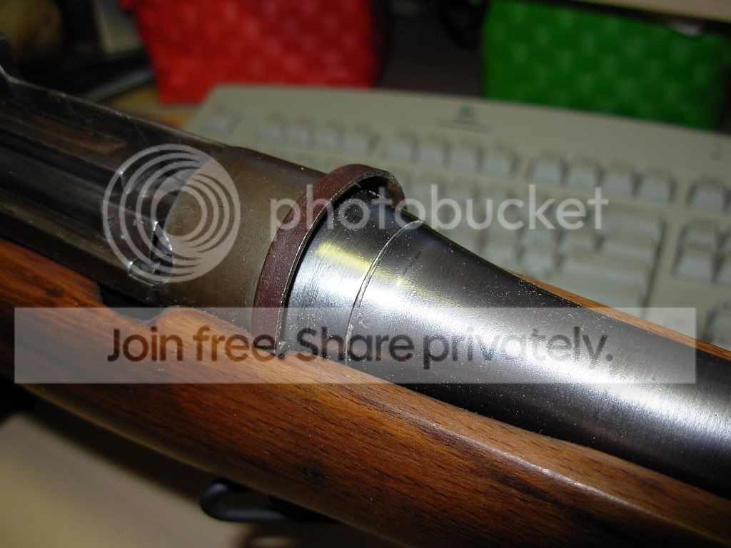

I was under the impression that enfield barrels generally didn't have enough meat on them to set them that far back. IE - you'd have a gap under the reciever ring where the barrel was smaller than the ID of the reciever ring.

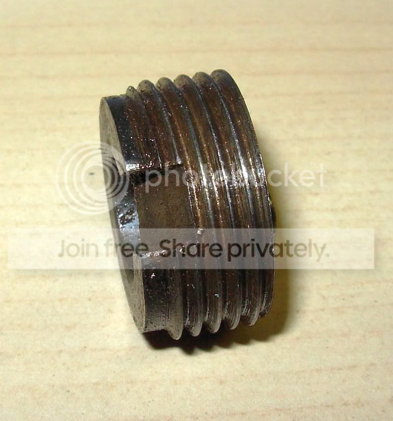

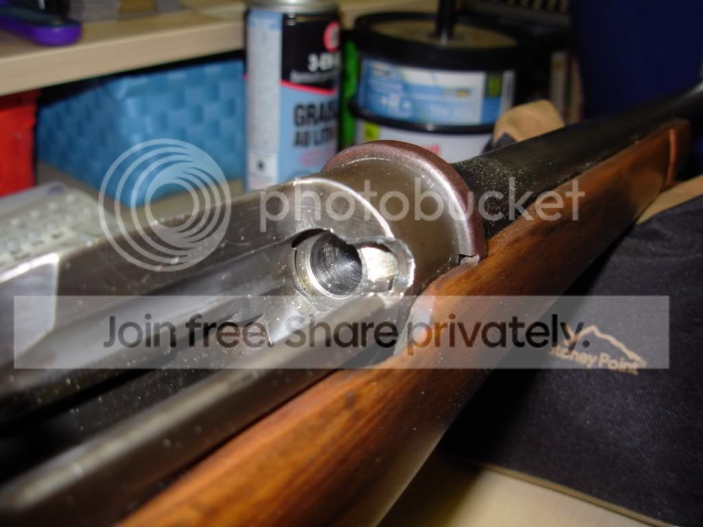

My enfield barrel ended up getting cut right around the groove at the end of the threads before the shoulder (cant think of the proper term). The neck and throat are still in approximately the same spot (.303 neck is longer than 7.62x39) as the .303 just a few thou deeper in. As such, there is a short un-threaded section before the new threads start. If I recall correctly I have one less thread on my "new" barrel than the old because of this. My "new" barrel also only bears on the outer shoulder. I was concerned about that for a while until I realized that the AIA guns used a barrel nut (I nearly went with one myself) and one selling point was this "easily adjustable head spacing feature". I gather that a barrel of this type only bears on the shoulder provided by the nut. Special Interest Arms appears to use a full length barrel that bears on both inner and outer shoulders and has the chamber face set back into the barrel to still rely on a stock length enfield bolt head.
Here is what's left of the old barrel... Add to it the .125" width parting tool and the facing cuts made to the remainder and that's how much was chopped... you can see the unthreaded section at the beginning, the new barrel has a slightly longer unthreaded length.

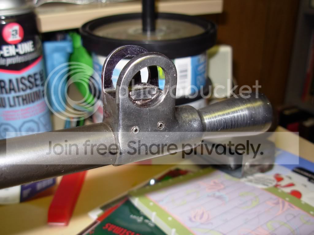

is that a custom flash hider? it doesnt look like a real no5 flash hider

Not much to see with the barrel... The OD was turned down a bit concentric to the bore to facilitate mounting it in the chuck for facing and reaming. The collar was silver soldered back on to allow the use of a standard upper hand guard retaining ring. I was going to go with a threaded barrel nut but decided to see If I could pull it off with a standard shoulder first. It's a little hard to see the gap left in the hand guard around the knox form due to shadows but you can get the rough idea of how far back it has been set...
Not much to see from this end except for the fact that the barrel isn't bearing against the inner shoulder, that and my less than perfectly smooth chamber :redface: ...

Sweet Zombie Jesus! someone finally commented on it!!! I swear I spent more time on the flash hider/front sight than I did on the rest of the conversion. I made it up off of pic's of No5's I found on line. nothing is to scale with it, just something to give it a No5 flavor. It also has a set screw that fixes the blade sight in place to ensure it doesn't go anywhere.

Oh and yes I did notice your No5 ish flash cone, Nice work on that one, did you make it in 2 parts and then weld them together for final machining or did you do it all in one piece?
Yup, two parts welded together... You don't think I cant afford a milling machine do you? :D

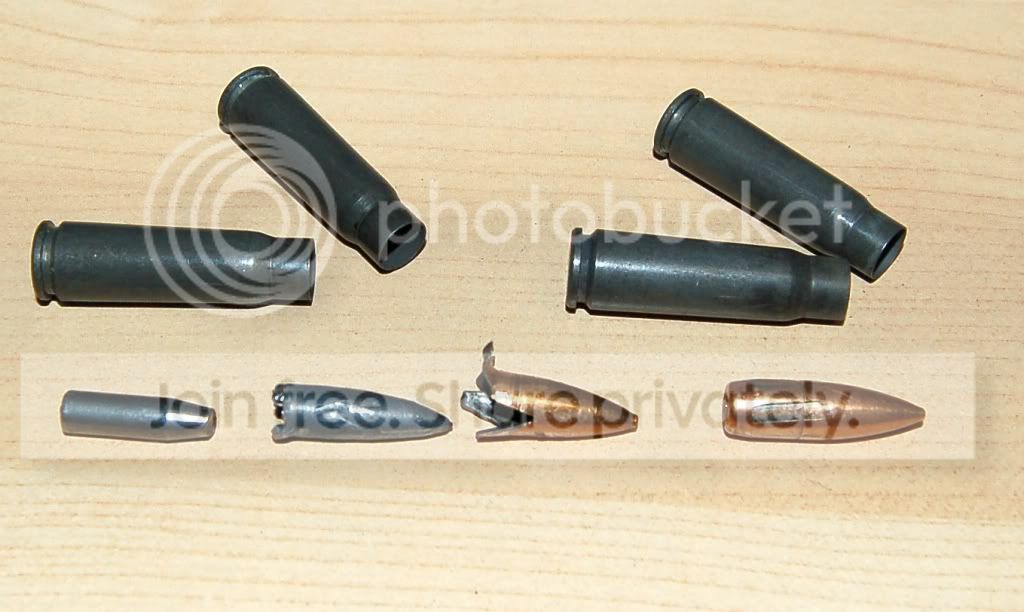

I have been struggling with hard extraction and have been polishing the chamber with felt bob's/compound and 3M pads after each range session. My last session went about 78rnds before I had a stuck case that required a rod to knock free (all previous stuck cases have been popped out with a screwdriver levered under the rim. I have tried to reshape the extractor and boosted the extractor spring with a wedge of rubber. I'm close, but still have some work to do.

On the left: cases after first chambering. On the right: Most recent cases after a few polishing sessions. The torn apart bullet was me being bored and wondering if they were steel or copper jacketed (there copper plated steel) and the other is a lucky find, a fired bullet churned up from the burm. It's five groove ccw rifling (is that considered right hand or left hand rifling?) so I think it's from my gun, I don't know how SKS and VZ's are rifled so It might not be mine... An interesting find none the less...
