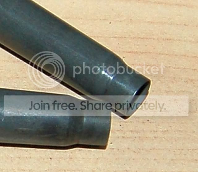

Yes, I suspect so...
You can see a bit of a white-ish haze around the neck of the upper case here...
Some of the fired cases have far more pronounced "hazing" around the neck. My chamber is likely a little looser around the neck than a factory chamber cut with a proper reamer... It might be overworking the case or blowing a little gas back around the neck and softening the coating causing the occasional stuck case. I should cast my chamber and see how it turned out, perhaps I could polish it a bit more... Whatever the case, if clearing a few stuck cases is the price I have to pay for ~$5 boxes of ammo it's fine with me.

My cases look like that after firing in my Mauser conversion, but then again it has controlled feeding and extraction. Not one hiccup after 100 rounds.
I'm now in the process of converting a Rem 700 to take the same round and modifying the bolt as I write this. We shall see how it feeds with a push feed. More to come.
I've been getting stuck cases in my Robinson XCR when I use some of the newer surplus (about '84 vintage, comes packed in plastic). I notice that the primers are quite flattened, which suggest some higher pressures, ( the newer stuff is about 200 fps faster (around 2500 fps) than the older stuff in the blue boxes, and that there is usually a bit of a ring around the base of the cartridge. I suspect the case is bulging ever so slightly, and after the chamber gets a bit of carbon buildup it starts sticking. Since the XCR chamber is probably somewhat tighter than the SKS chambers, :) I guess the only thing to do is clean the chamber more often, which seems to work. I don't know if honing the chamber would be the answer, you probably know better than I.
