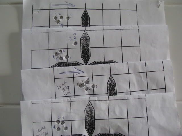

Well, got some "warmer" weather and some time to go shoot the New powder and it ROCKS!!!!
Out of my 28" 7 twist Shilen, Hornadys new Leverevolution pushes the 90gr Berger VLD at 2875fps with accuracy in the 2's and vertical in the 1's. WOO HOOO.
All targets shot at 200yds in temps from 0C to around 6C.
Conditions were light gusty winds in the left to right direction as indicated on the targets.
Top group shot 3 was wind as I saw the mirage pick up but didn't think it would move the bullet much. Waited for it to calm and dropped the 4th shot in a nice triangle with the first two.
Only shot I am unsure about is the high right on the second target marked with a ?. Thought conditions were good and the shot felt ok so not sure why it went way out there????
The lower groups were shot on another day. I have retested on 3 occasions and the groups are stable. The temps have varied quite a bit and the powder still seems pretty stable.
Lots more info to come as testing goes into the warmer weather.
Jerry

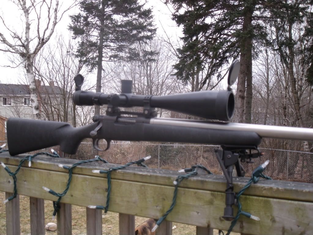

Remington 700
1/7 Shilen MS barrel (28'')
Sightron 10-50x60 scope
NF rings and bases.
Bolt/action trued, and bedded by Sam Adams.
Now, to see how she shoots.
I can certainly see a call to Ian Robinson in the near future. Just want to see if it will shoot past 800 first.
