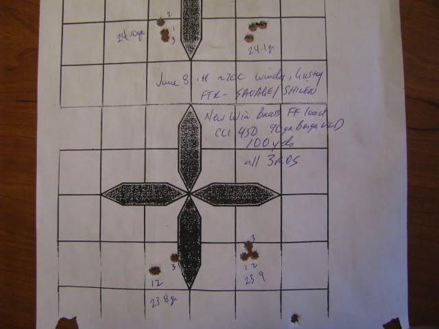

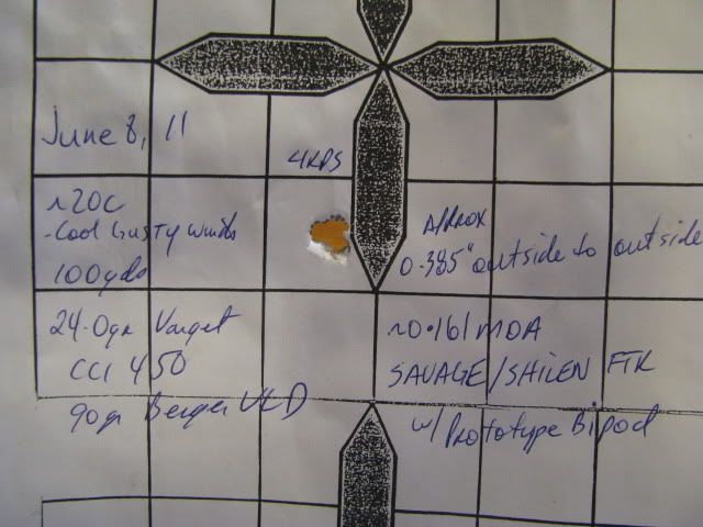

Well, it looks like Varget is going to work out just fine with this Bullet and Barrel. Confirmed at 100yds today with some cool and gusty winds. These 4rds were shot between gusts.
The load also shot great at 300 and 500m. AND in 30C heat. Will do some testing out to 1000yds shortly.
Some 3rds groups using new brass to find a fireforming load and still be able to practise. Looks like 0.1gr less will do the trick with this batch of brass.
The barrel has digested just under 1800rds and these groups were shot without cleaning the bore with 95rds fired. I am liking this for a competition set up.
