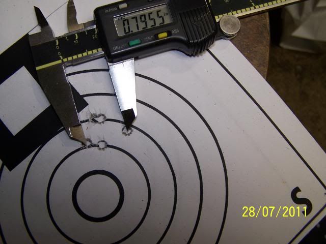

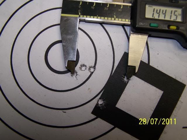

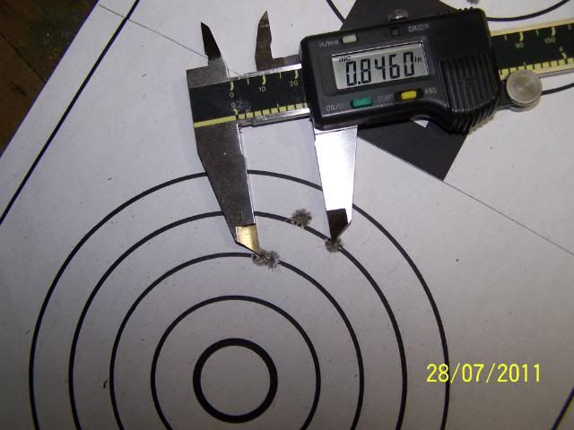

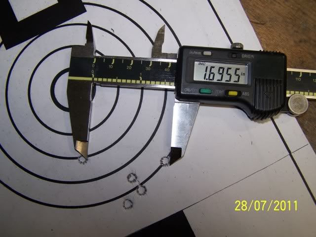

Here some loads starting to show promise with a non heat sensitive powders
Shot on Wed this week good conditions as it got later winds died groups a little smaller
Quite a few fellows had problems with there loads at the Eastern F class Championship when heat was in the 30c+ .308 included
Ran some loads to 2940 fps accuracy not there 2750 to 2850 seems to work best
Groups where at 300 Y off bench all 5 shots one group looks like 4 but there was 5 not quite a 1/4moa gun be getting there, Liberty shot a 5 shot .520" group and thats a sub 1/4 moa at 300
Lapua brass NT
Fed Gold Match as I mentioned FGM give more speed than 450 Magnum CCI
90gr VLD Bergers HP
To many powders to list, Anything faster than H 4895 did not work with the 90gr bullets, Buldog lets us know on the Alliant AR Comp 15,

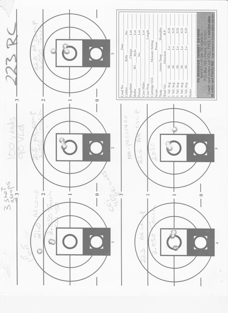

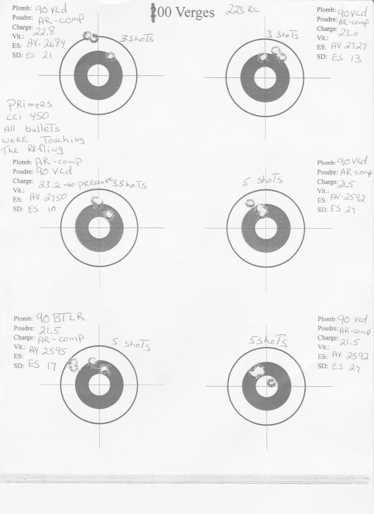

picked up some ar comp to give it a try with the 90s.seems how i had no ideal were to start with this powder i started low and worked up slowly to see were i would start to get some pressure.stopped at 23.2 and had non,will gradually go up some more in .02 grain increments.
so far i have nothing out of the ordinary,my goal is to get up to 2850 plus fps with a minimun of a half moa or better for f class.
my rifle is a pierce single shot action 30 inch krieger with a 1 in 7 twist 4 groove.i will post more results as my testing goes.so far with the little bit of testing that i have done this powder does not seems to be dirty.
There almost always seems to be one flyer out of the group, maybe due to inconsistent seating depth? You say they were all touching the lands, but the difference of being jumped-touching-jammed is obviously quite small. Just my way of doing things, but I never get closer than .005". Either a minimum .005" jump or .005" jam, never less just to take out one more variable, especially with a relatively new combo. Going up in .02gn increments is a waste of powder IMO, these are load sensitive, but, no sense doing less than .1gn for pressure testing. Once you are in the right node then you can try and take it further. This is all just my opinion, of course. YMMV
By the looks of it, you shouldn't have any problem getting up to 2820-2850 with it. What is your OAL for these loads?
