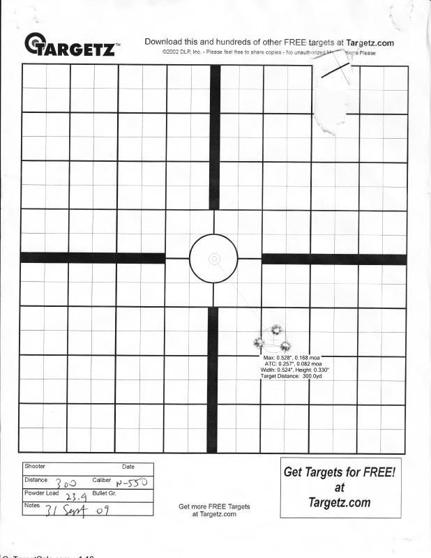

According to my software program you could be running Varget up to about 24.4 grains before you approach the high pressure levels at 64,000 psi. It might be an idea to run a pressure trial then accuracy OCW test. Also, I have been thinking of trying H4350 the same as your thoughts. I tried H4350 with 80 grain bullets and while the accuracy was good, Varget was better at higher velocity so I dropped the idea. My rifle has a longer throat so I will try H4350 on Friday. Steve
I hope your not going to be messing with the 22BR load you have.
