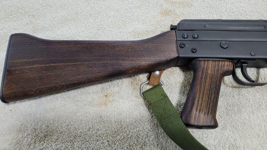

How do you find the cheek weld with the fixed?
For me, I'd have to shave down the stock on the fixed to get a better cheek weld... Like this guy did...
