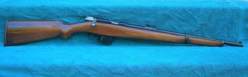

I agree with ye on that. (y) I've never bothered with the 9mm Para cartridge in a rifle. I preferred the longer 9mm Largo chambering in the
Spanish Destroyer carbine that I hunted & plinked with for a tad past 20 yrs. Favorite load was hardcast 158 gr SWC bullets at 1000 fps.

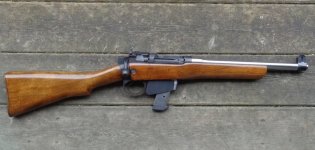

I changed over to 45ACP in my LE build as its impact on critters be more effective.

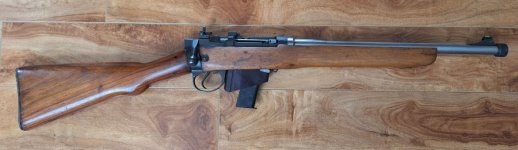

You got the SIA mag adapter right? Do you got the spring loaded ejector?
