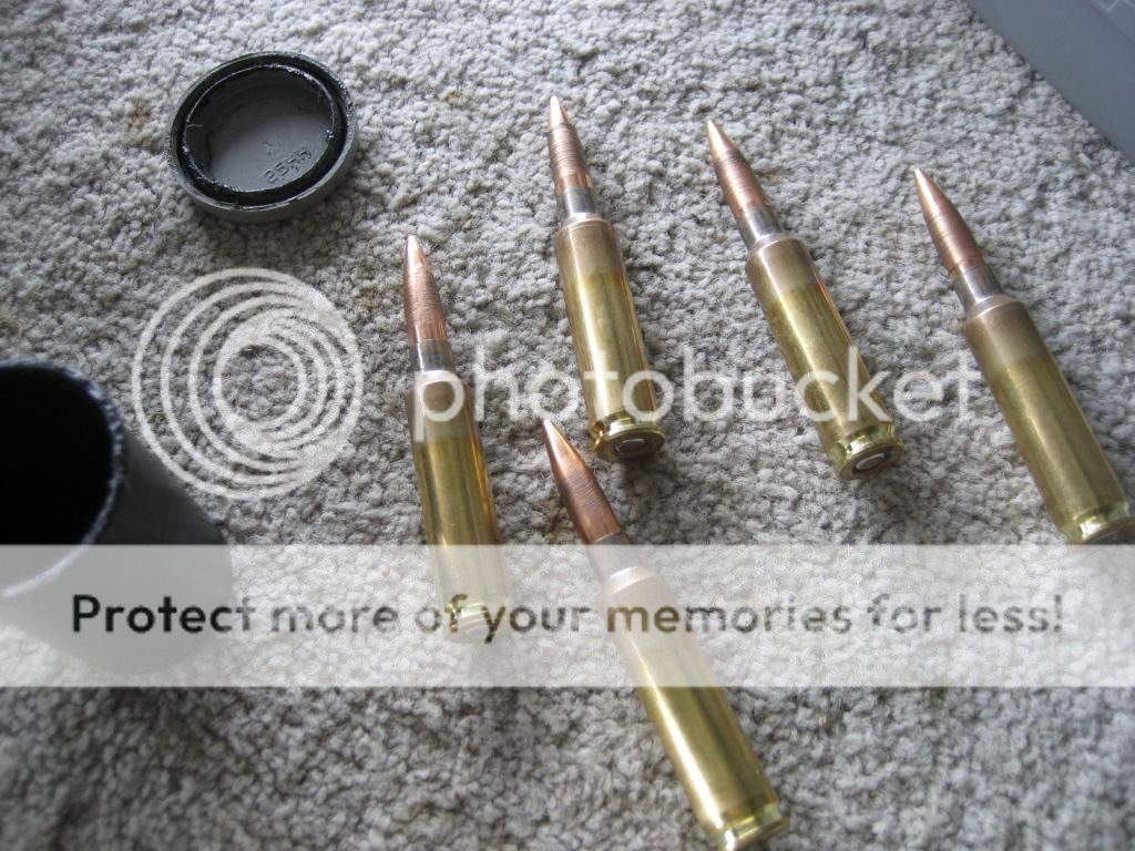

Do you realize if people would "READ" what I posted they would have a much better understanding of this subject, the problem with lubricating the bullet is if any excess lube gets in front of the bullet and behind the bullet and on to the case.
Grease or oil in front of the bullet increases chamber pressure and can cause a bulged barrel, grease or oil on the case increases bolt thrust and can double the force on the bolt. The problem with greasing the bullet is the individual doing the greasing and the correct amount that does not increase chamber pressure and bolt thrust.

Lead cast bullets are lubricated in the bullets grease grooves, the problem is jacketed bullets do not have grease grooves and any "EXCESS" lube will end up in front of the bullet or behind the bullet and on to the case itself.
And this is why I quoted Murphy's law: Anything that can go wrong will go wrong.
And the safest thing to do is unload the ammo and keep any grease out of the bore and chamber and not have the same problem the American Army shooting team did in 1921 when greasing bullets.
Greasing bullets is an accident waiting for a place to happen and the reason why bullets are "DRY" lubed with Boron Nitride, Tungsten Disulfide, or MOLY.
