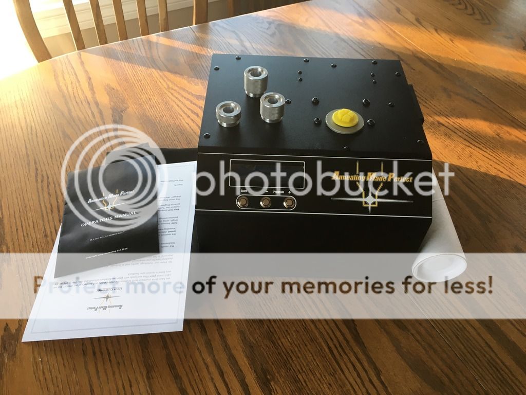

It was packaged pretty good definitely tight so nothing would move around. Here is a couple pictures of it getting unpacked and everything that comes with it.

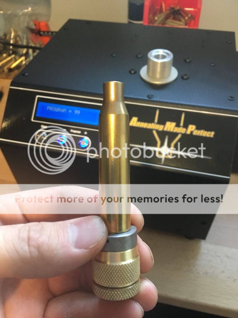

This machine seems like it is built really solid and was so easy to use within 15 minutes of unpacking I was already annealing some 338 lapua brass. Its actually really surprising how easy to set up this thing is basically you plug it into the wall look up what pilot you need and the setting for your calibre and brand of brass. Press the plus or minus buttons till you get the to the setting you need. Screw in the proper pilot. Put your shellholder in the supplied holder. Use the shellholder to put your brass in the pilot and press start. Done.

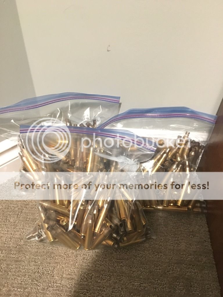

Here's a couple pictures of the 338 lapua I annealed.
Before
After
7mm R.E.M. Mag
Before
After
And 308 win
Before
After

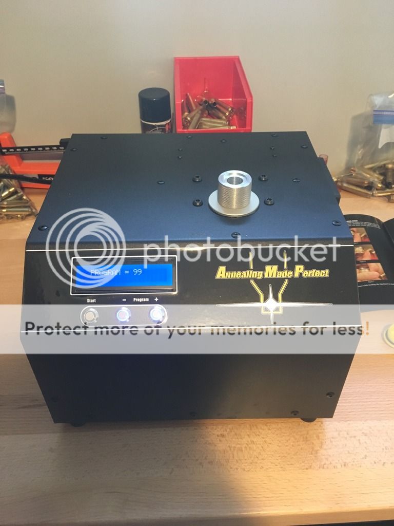

Here's a few more pictures of the machine
Overall I am very happy with the results of this annealer and the simplicity of it when I bought this I was really hoping for a nice dummy proof system for myself and that's what I got.
