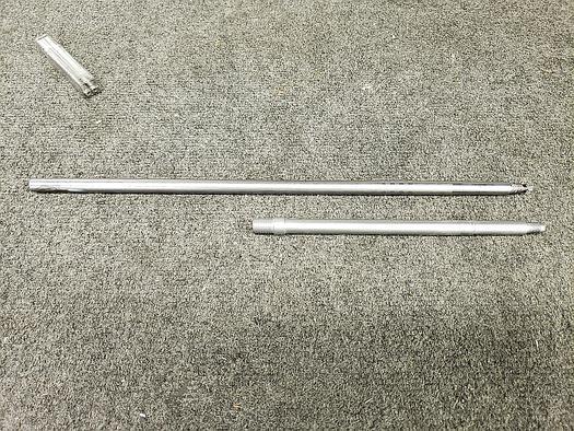

OK....so, we have the first three 9" barrels made up, chambered, blasted and ready to send for blueing. They should be back by mid next week and ready to install then. The nice guy that lent us his rifle for R&D has first dibs on barrel #1. The other two are up for grabs. First come first served.
NOTE : These require PROFESSIONAL GUNSMITH installation. Once they leave our shop we will not be responsible for any part of the installation or issues that may arise from the change. Your gunsmith will need to install, cut the extractor notch to match your trunnion and tune the rifle if required.
DISCLAIMER : If you install or have this barrel installed and do not pin your folding / collapsible stock and your rifle is shorter than 660mm in it's shortest configuration then you will be in contradiction of the law and may be subject to all of the bad things that come with that. Under no circumstances will we be responsible for YOU breaking the law.
9" barrel with a 1/2-28 tpi threaded muzzle :
