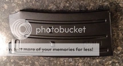

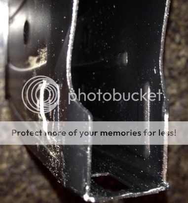

Today the last shell in a magazine failed to feed. The cause was likely operator error when loading the magazine. I was using Federal Prairie Storm 2 3/4" 5 Shot. The magazines have indents in them. One is L shaped and runs up the side of the magazine near the back and then the short leg of the L is parallel to the magazine lips. The rim of the shell got caught on the short leg of the L and got stuck too low for the bolt to catch the shell and push it forward into the chamber.
When you load the magazine the rim of shell normally goes between the indent and the back of the magazine. The indent prevents the shells from sliding forward in the magazine. I started using my finger to push the follower down to make loading easier. What I think happened was I pushed the follower down too far, inserted the shell with the rim below the short leg of the L. Since the magazine can hold 3" shells the was lots of room forward of the indent for 2 3/4" shells. The shell rim got caught on the indent.
Might not make sense but I'll try to post photos tomorrow.
L Shaped Indent
The short leg of the L inside the magazine where the rim of the shotgun shell got hung up.
I loaded the magazine and tried to flip it forward so the momentum would force the shot shells forward and allow the rim to get hung up on the short leg of the L. It didn't work and I was unable to recreate this malfunction. So I still think the shotshell that jammed was loaded into the magazine incorrectly.

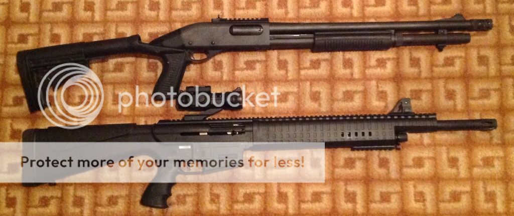

Purchased a BR-99 CL1 and have had it out to the range three times now. Most of my shotgun shooting is club level three gun shooting steel targets or static clay pigeons. Up until know most of my shotgun shooting has been with Remington 870 pump shotguns. Currently I am using a 870 Tactical. Hoping to use this shotgun in future club matches.
It came with two five round magazines and three chokes (IM, M, IC). It semi-automatic with a 20" barrel. It has AR style controls (safety, magazine release and bolt catch). The cocking handle is in the right side of the receiver. It came with a rubber cap over the cocking handle. It was useless and fell off immediately. I am not sure if it was only to prevent the cocking handle from piercing the box or was to address complaints that the cocking handle is too small and sharp. It has an A2 style carrying handle with an adjustable rear sight. The rear sight has a round peep sight and a U notch sight. It has a polymer A2 style front sight. There is a full length picatinny rail on the receiver and front hand guard and a short rail on the bottom of the hand guard.
The shotgun does feel as cheap as I expected and actually feels quite durable. The rear sight and carrying handle is functional but is plastic and feels cheap. The shotgun feels slightly front heavy. Of course when loaded the weight of the ammunition doesn't make it feel even more front heavy like tube fed shotguns. The butt is hollow and I have read online that the butt can be filled with a bag of sand to balance it out. I don't think it's a big enough issue so I won't be doing this.
