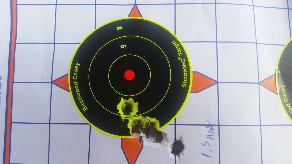

I think I posted these earlier, I was using Hornady 168Gr zmax and you can see the top two rows are pretty consistent 1-1.5 MOA at 100. 5 round groups, 5 in a row. (The bottom left was another shooter CR5, still about 1.5 but he usually outshoots me!)
This was my first day out with a new Vortex Scope that I think I will keep.
4 shots touching, the fifth shot just about.
This one I seriously had a F*@$ing Horsefly bite my leg on the one outside of the circle, it was an easy 1 MOA till that point.
