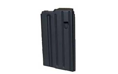

Why can't you guys source some metal type mags like
http://www.irunguns.com/product.asc-mag-308-win-20rd-black-ar-rifles-308-20rd-ss
I don't see why this type of metal ar-10 style mag wouldn't work. The metal 20 round mags in my opinion would be the best mag for this gun.
I'm considering importing some of these mags. Anyone know if they would work for sure? I have a bunch of ASC 5/10 round mags that work great.
It'd be one thing if the ATRS mags were done, but they are not. Until they are I don't understand why it doesn't make business sense to order in some of these metal mags to ship out with the rifles. It would have be been nice if they included an IMI mag with my rifle. Mine came with zero mags and zero help on where to find a mag that works except 1 email link to an out of stock website selling xcr-m mags.
Now I don't run a business and have no idea what reasons ATRS have for what they do, and I'm sure they are probably good reasons.

We CAN source these mags as we ARE allowed to import PROHIBITED mags and devices. the problem there is that they are 20 round mags so we could not sell or even give them away without breaking several laws.
These would need to be pinned to 5 rounds BEFORE they could be imported into Canada in order to sell them to anyone except an LE or military agency.
We shipped out several rifles AFTER explaining to the recipient that we did not have any XCR-M mags which we know work well. Rather than us paying full retail for the mags we felt it was better to direct the client to a source that had them available. I apologize if another retailer sold out of these before you got to them, but this is rather out of our control.
We have MANY thousands of dollars in mag inventory that is for the most part useless, so rather than continuing to spend tons of money on mags that may or may not work we decided to invest a TON of money into making mags that A) we KNOW will work and B) we know we will always be able to supply, thereby greatly reducing our dependence on a maker in a foreign country that apparently seems to not be able to supply ANY of the Canadian dealers with enough product. To my way of thinking the route we chose was the most responsible to our clients past, present and future despite the huge capital investment on our part.
