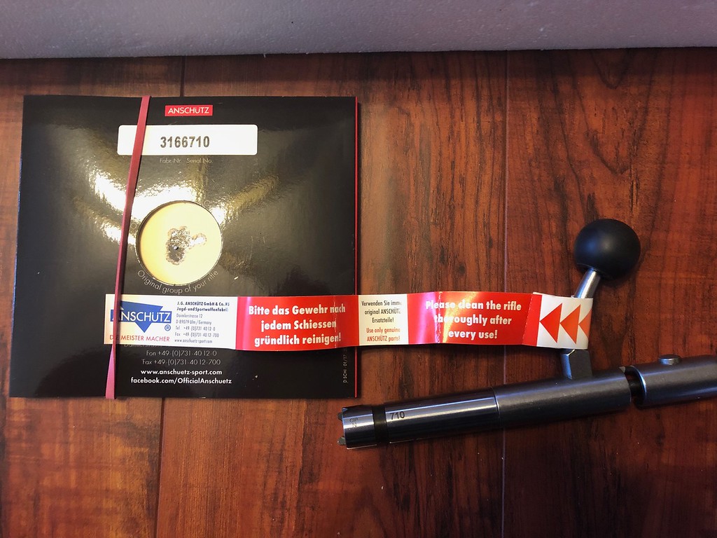

To keep things in perspective, you can also spend a fair chunk of change on a high-end rifle, and discover an interesting request on a tag attached to the bolt. :)
