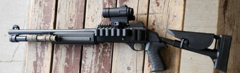

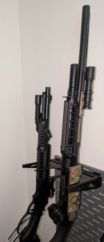

View attachment 1216818View attachment 1216819
