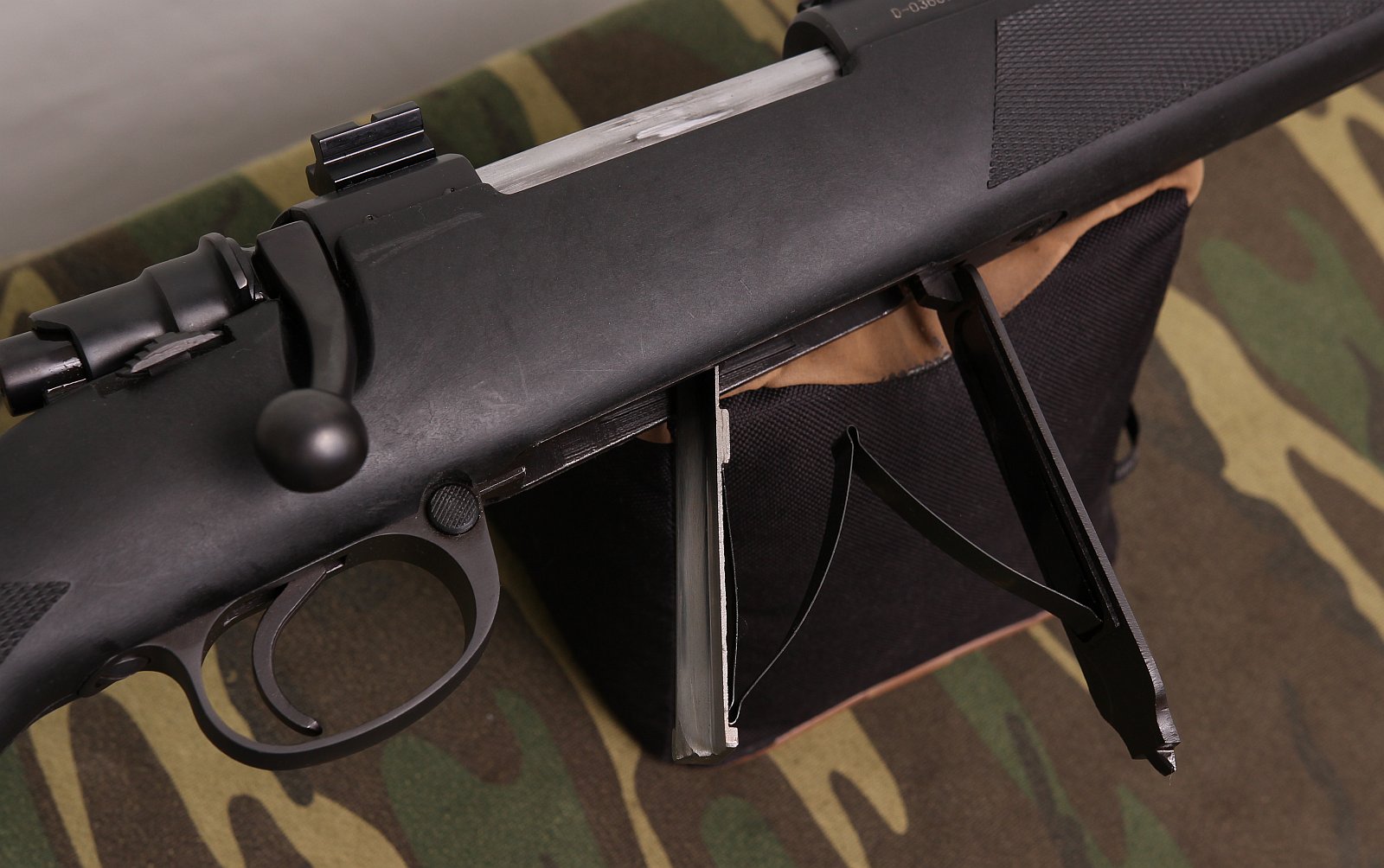

A view of what you get if the stock does not get some clearance for the hinge part to swing up - forward of the hinge pin - and then apparently pry or force the floor plate open anyways - is also possible that one side of this magazine was also epoxied to the wood stock when a "bedding" was attempted, at the same time. Beyond repair, so far as I know - the front of the "tongue" with the part for the front action screw, was not with this, when I received it.
