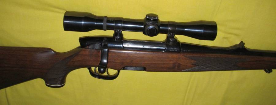

For scope clearance, I would avoid butterknife handles if I were you. However, if you must, a cheaper and easier alternative would be to buy a used Brno 21 from Tradex, harvest the M98 butterknife bolt and part the rest out.

Butterknife bolt handles were being added as a custom touch to factory rifles by gunsmiths in Canada before Jason was ever born and before Ralf ever set his hands on gunsmithing tools, much less immigrated to Canada. I know of at least three of them out there who are still doing it - two of whom are members here - and that's just in BC; nor am I particularly knowledgeable of the gunsmiths out there today. Also in BC, aside from the three gunsmiths I know of, Ralf's former partner Martin Hagn probably would do such a small job, as would Waffen Weber in the interior.

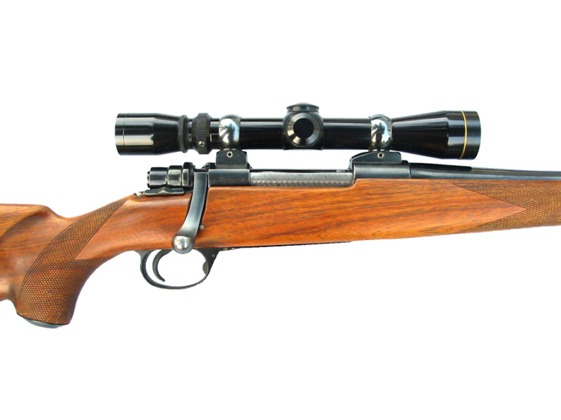

I would not expect this modification to a conventional bolt handle with a ball end should be difficult for a gunsmith who knows his business, nor should the work require so many hours as to make the cost objectionable. The rifles I have chosen to have this small custom modification on have been done at very reasonable cost.
It isn't hard to modify a ball end bolt handle to a butterknife handle, including having the outcome being both pleasing to the eye and the hand, as well as still fitting into the bolt handle cutout in the original stock.
This is an example of the first one I had done like this, sometime back around the end of the 1970's, on a Husqvarna Husky rifle - and those svelte actions are also a fine platform if your desires aren't restricted to something with 'Mauser" roll stamped on it.
I don't know why anyone wanting one should avoid them, unless perhaps they insisted that a butterknife style bolt handle must be of the original designs from the turn of the last century. Mannlicher Steyr is one example of a manufacturer making rifles with that style of bolt handle from at least the 1970s forward that is intended for a rifle that will have a scope mounted. A school/hunting buddy of mine bought one of their rifles in 30/06 back in the 1970's, and they are very fine rifles indeed.
