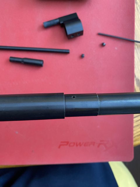

It uses pointed set screws that locate into pockets on the barrel. Pg 15 of the manual shows that. I don't think the WK180 does this?
Correct, as this is missing on the WK, and great to hear on the Siberian! It might be too trickier to use a custom barrel as a result, but probably still doable.

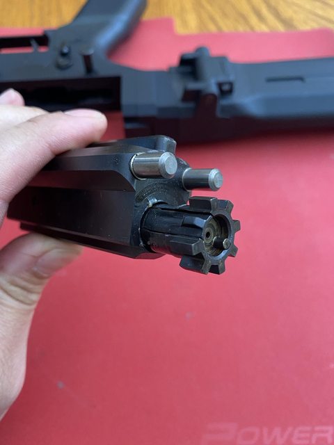

.223 5.56 and .300BO all use the same bolt. Fairly good chance this is a common 180 bolt so x39 bolts from other manufacturers or AR15 bolts with the gas rings removed might work.
Doh, can't believe I forgot Blackout uses the same bolt! :p A 7.62x39 mm may also work for Grendel, too; hopefully a de-gas ringed AR bolt will work.

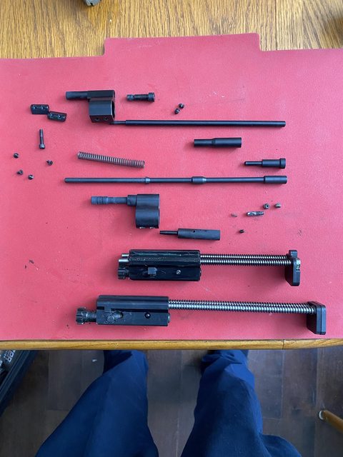

Well, I’ve got a bunch of photos but I’m not sure where to host/upload them?

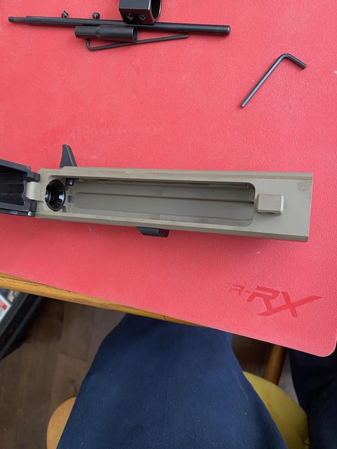

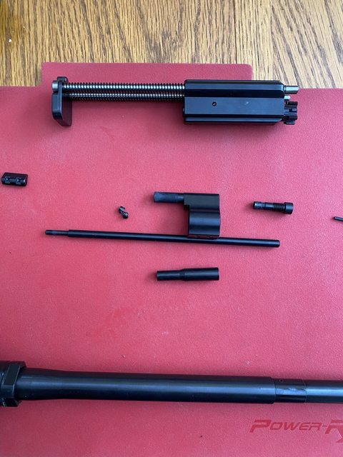

I can confirm the gas block is held via two pocketed set screws.

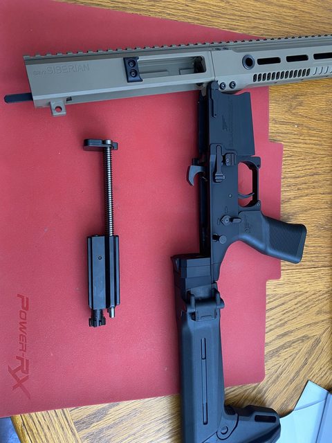

I lean towards disassembling this rifle when you purchase it as there is a distinct lack of lube/grease on it as delivered, and I found a couple of the screws seemed on the loose side and could benefit from a drop or two of loctite I’d say.

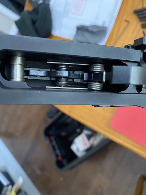

Overall disassembly is pretty simple though. I didn’t get into removing the trigger assembly because I’m just not looking to mess with the springs at the moment.

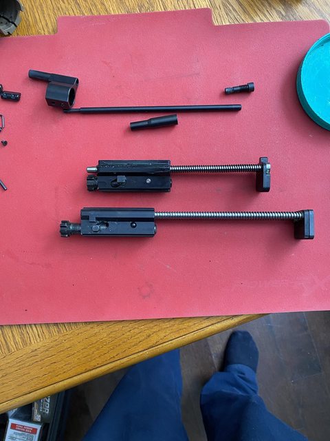

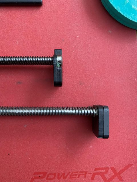

I’m not sure I quite get the how to share, but at least here’s a link to the album. I got some shots comparing it to my R18 as well.

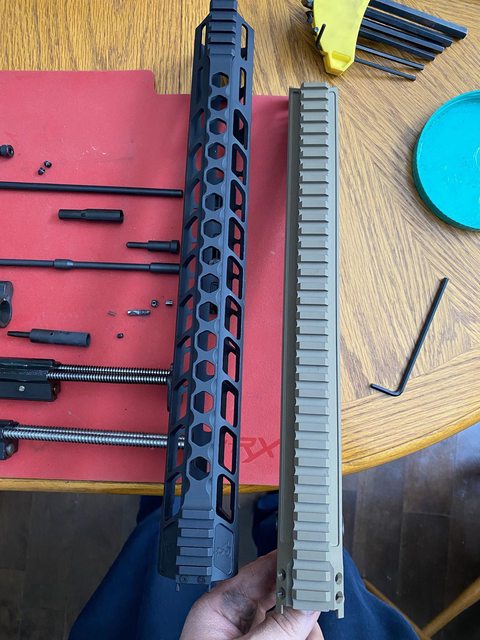

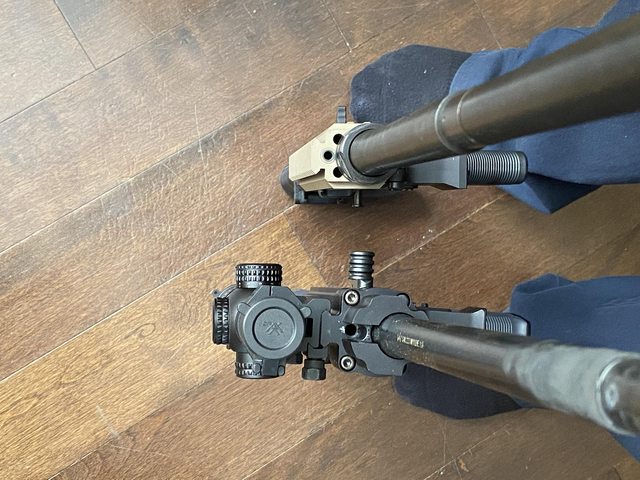

Cool to see they shrunk the length of the rails as well compared to the Sterling; I imagine the Siberian is shorter then the Sterling?
Did you have to remove the gas block to remove the piston? Thanks!
You can't remove the piston and cup without removing the gas block? If that's actually the case that's a ridiculous design flaw.
I figured it'd be like the original where there is enough play between the cup and rod that you can pull them apart and slide them off.

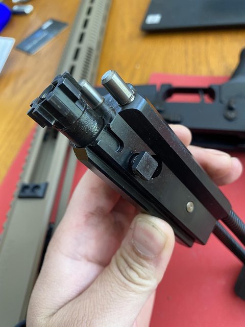

Yeah the gas block needs to be removed, there’s no way to get the piston out otherwise.
how about splitting the upper and lower, would that release the piston from the block after the carrier is removed? can the handguard be removed without any difficulty? not crazy about removing the block to clean the piston.

thanks for stripping it down, I'm going to go back and clarify what I posted earlier. no way in hades am I going to remove the gas block to clean the piston, if anything I'm reaching for the red loctite to keep it in place. now going back to my earlier post, can the upper and lower be easily separated so one can insert a reaction rod and spin the barrel nut off? this is very inconvenient but from my perspective the only way to get at the piston and block for a proper scrubbing without taking the block off the barrel.
The forward pin on the upper/lower is retained by a detent ball I believe. I think it would be popped out with a punch and the two would separate without issue.
I didn’t try it at the time but I don’t think it would be any more difficult than any other AR type platform? It’s very similar to the R18.
If anything you’d find it more annoying removing the hand guard. It’s a tight fit too the upper, but might loosen up after a few goes.

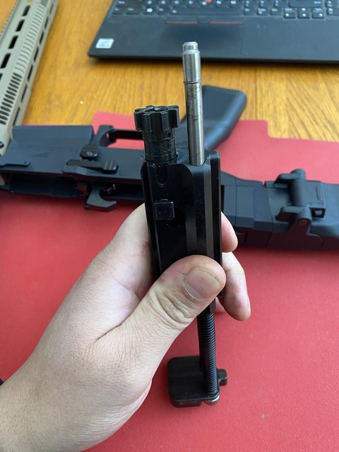

The thing with the piston is it sits about an inch into the upper, but only has about 1/2” of stroke/play. There isn’t a way to remove it from the gas block with that amount of room. The R18, despite having significantly more stroke, has the same style design (for the record, as I type this I think it might actually be possible. Again, amateur here)
