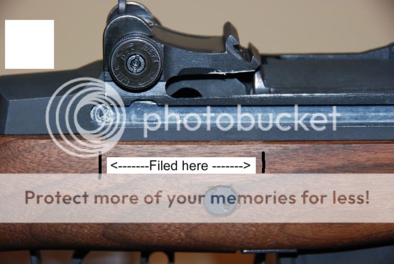

That's how my Boyds stocks came as well. They're not designed to fit a chinese receiver. If you take a look at a US made receiver be it a USGI, current Springfield Armory or a LRB Arms, the right side is milled a little different.
Here's how my Poly fit in the stock after 5 minutes with a file -
It fits great now.
