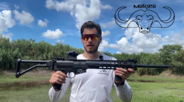

First look at NR version of Makasi. Same handguard as the US 16" barrel version. Carrier key still unstaked. Also holy hell what is that heavy profile barrel?
